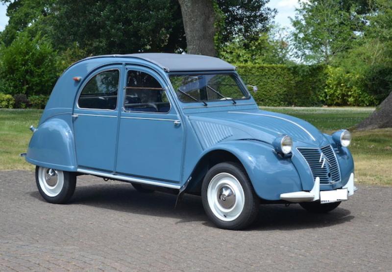

The term BHP came about predominantly from the automotive industry where various fiscal and simple calculations were made on engine size etc to arrive at a fiscal or nominal horsepower. E.g. in France the classic 2CV (2 Cheval Fiscal).
Now anyone unfortunate enough to ever drive or be driven in one of these crates on wheels will know that they are not over endowed with real power, but they have more than 2HP (1.5kW). Hence to act as a term of "real" power from a car engine, people then started using the term Brake horsepower meaning "real" power delivered at the engine shaft output. Put any car on a rolling road and measure power transmitted to the road after going through gearboxes, having power sucked out by A/C, hydraulic pumps, alternators etc and it will be quite a lot less. However it is difficult to measure this so the term BHP has become synonymous with engine power / speed / acceleration.
SO in short forget BHP and HP and just say motor shaft power or shaft power or fan output power or wherever you want to define your power measurement location.
