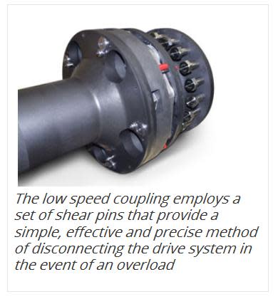

In the new gas treatment plant located in Algeria (JV), the first gaz was exported in the mid of December 2017) , two weeks ago from now , during the operation of the Solar turbine Generator it was happened a serious problem for two machines (09 MW by machine), that was the shearing bolts of the fixation of the coupling between the turbine and the generator
The investigation is ongoing to find the real causes of this failure by the Client /Contractor
May be someone met the same problem in the past that could give me his feedback about an idea about the failure , causes and the solution implemented to solve this problem definitely

A general arrangement drawing and nicely detailed pictures of the failed bolts' fracture surfaces and the couplings would be useful to mull over until the sheriff arrives.
RE: Shearing bolts of the fixation of the coupling between the turbine and the generator (09 MW)
given the limited information, and there was no mention of coladeral damaged one would expect from a "normal" coupling failure, could it be possible the turbine is equiped with a "shearing coupling"
If so, the reason for the overload would need to be identified
Thanks for the picture, It looks like there is groove machined in the middle of bolt shoulder? Then it failed right through the middle of that. We would need a close up picture of the fracture surface to actually see how it started and if it follows classic shear or if there is striations which would indicate fatigue from bending. The groove is concerning though, not sure of the reasoning behind that feature. would have to see a coupling drawing.

Perhaps I should have said SOME OF YOUR BUDDIES ON ENG-TIPS WOULD APPRECIATE a general arrangement drawing and nicely detailed pictures of the failed bolts' fracture surfaces and the couplings would be useful to mull over until the sheriff arrives.
