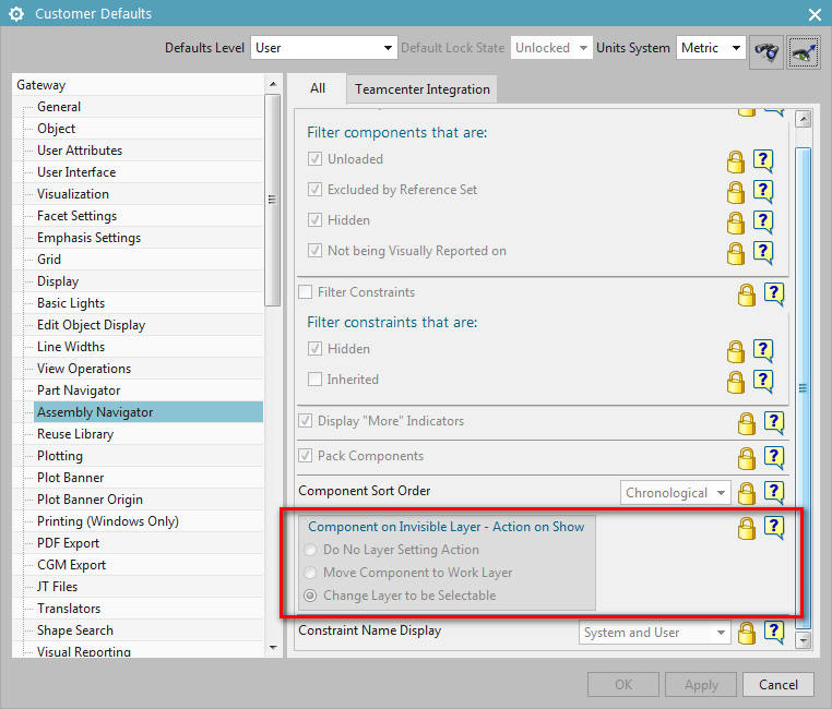

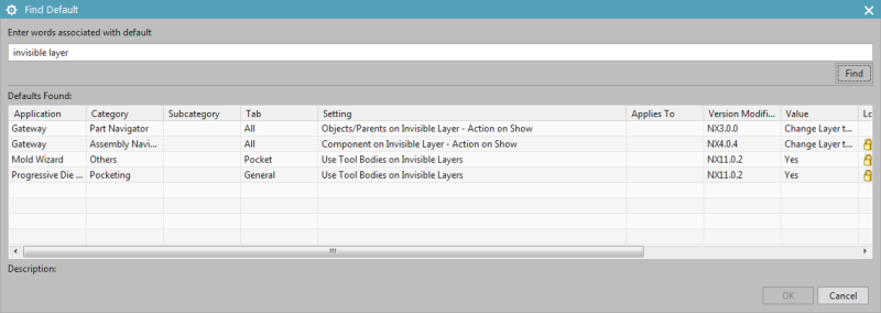

In the Customer Defaults when we were on NX9, there used to be a setting where I could have a layer turned off and if I selected an object in the Assembly Navigator that had that layer turned off it would not come back on. I haven't been able to find it since we went to NX11. Does it still exist?
NX 11.0.1.11
RE: Leaving Layers Off in NX11
Still there I guess...
(screenshot from NX11.0.2.7 Customer Defaults)
Thanks. I saw that but I guess I misinterpreted what it said.
And thanks for the quick reply and easy instructions!
