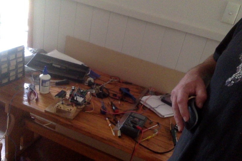

Here it is, my carpentry skills are almost as good as my soldering which are nearly as good as my photography. Damn I'm hot. Oh that's my beer belly being used as a mousemat, the grues have eaten all the cameras so I used a laptop instead.

Notes for the OCD people. Yes, the multimeter is the world famous FUKE brand. Twenty dorrar. A keen eye will observe that if I screw the plywood to the wall I can either have vertical heatsink fins, or a horizontal display, but not both at once. Also, I have carefully hidden the pot shaft beneath the power supply jack, to make it more difficult to use. That's why we build prototypes.

It's glorious.
What's it do?

It goes "ping".

I see some unused space on the breadboard. Enough for a real-time clock so that it can "ping" on time.

My off grid house has a 48V solar system. It also has 6 very large 2V accumulators left over from a 12V system. I also have a 180W 12V solar panel used for camping. So, the 12V panel charges the 12V battery. When the voltage of the 12V system is high (say 13V), and the 48V system is low (say 51V), the relay closes and energises the 12V to 48V buck boost converter, for 10 minutes. Then the relay opens and it checks the voltages again, ad infinitum. I have had it running in the past but a tree fell on the shed and wiped out the existing 12V system. This version is better because it has a display. The next step is to put a current measuring chip in.

Not really seeing the birds nest, looks about like a lot of other prototype stuff.
One trick I've seen used is to buy ribbon cable (esp. the multi-colored stuff), cut lengths of it and split pairs/singles off the harness to route to other components. Even if it's a rat snarl of wiring, the look of it coming back to a single bundle in some spot or another makes it look much better (dare we say professional?).
I like the 2x4 and plywood panel layout though. Waterproof that with a few wraps of Saran and good to go, no?

But your breadboard deserves a slightly better housing, e.g. in addition to the plywood backing, screwed to the wall, a coupla short vertical 1x2s on the vertical edges to hold a piece of smoked plastic to act as a front panel/ display holder. I might leave the top and bottom open for ventilation, with maybe a horizontal shelf spaced above the top opening to keep things from dropping on the electronics.
