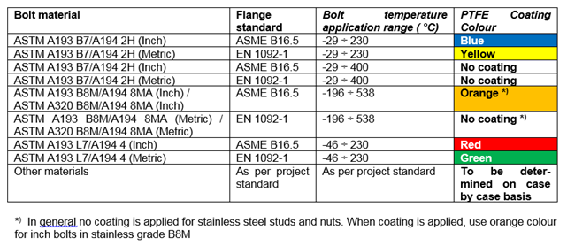

Here's a snap of what we have in our bolt spec, to identify colours

RE: A193-B8M bolt
XL83NL,
Is there any standard color for florocarbon bolt and nut ?
I look at again the drawings and found the bolt specs is A193B7 with note :florocarbon. The supplier gave us bolt not green color bolts and nuts.
Looking to your snapshot green is A193L7.
Syah
RE: A193-B8M bolt
No Standard....If you don't specify they will give you anything. The B7's I receive are blue on request.
RE: A193-B8M bolt
Quote (david339933)
Same here. Based on that, we made up our own standard and include the colour in our purchase order. L7 doesnt need to be green, it can be anything you want. I just picked the most obvious colours (to visually differentiate from) for the most commonly used grades.
