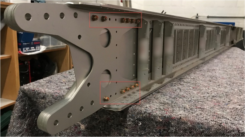

I'm working on the wing spars of a 2 seats light kit airplane.
The spars are already drilled and assembled by the factory.
Here an image of the root part:
I found out that the thread-lock-paint on some AN3 bolts was broken, so I wanted to re-torque them.
But I was surprised that the bolt had quite some play in the hole.
The bolt has a dia of: 0.1870 inch
The holes vary from 0.1900 to 0.1950 inch
Is this too much?
I though about going to a NAS6603-16 bolt because they are a bit thicker: 0.1885 to 0.1895 inch.
But these are shear bolts and have a shorter thread, so it will be difficult to use a standard washer and AN365-1032 nut and still have 1 to 3 threads protruding.
Are these joins in shear or tension?
What would be the best solution?
Many thanks for your advice.

@LiftDivergence
I've asked the kit manufacturer and the reply was that the holes are "okay"...
On the drawings, I have, no hole dimensions are written, so that I don't know.
Based on the info I have, a 3/16 or #12 drill/reamer should be used for AN3: 0.1875 - 0.1890 inch
So the pre-drilled holes 0.1895 - 0.1950 seem to have too much "play".
That's why I'm concerned.
I'm thinking about the forces on these bolts, these bolts hold the outside spar doublers (around 15 inch long) at the root of the spar.
Are these only for thickening the spar at the root and are the forces primarily in tension, in that case I can imagine that the holes are okay.
But when these bolts face shear forces I'm a bit worried.
What could happen when the forces are in shear and the bolt has to much play?
Many thanks for your experienced advice.

Here an overview photo of the spar:
RE: AN3 hole tolerance question
Looks to me like a great deal of shear loading will be picked up by the flanges top and bottom, especially since they look like they get bolted together.

In your first photo, some of the bolts do not appear to show much protruding thread. Is there enough?
The paint you see is not "thread lock paint" it is a "witness mark". It performs no locking function. It is there to "bear witness" to two things: the presence of an inspector who verified the torque on the bolt before it left the factory, and it reveals when the bolt is loosened because turning it breaks the paint. So in your case, it did its job.
In general (not specifically to your aircraft) to make a shear-resistant bolted joint, you do not need the big AN365 nuts - those are known as "tension nuts". If you have a copy of AC 43.13-1b you can find the recommended application for these nuts. If you did want to replace the bolts, NAS6603 is a good choice but may be more expensive than necessary, and for this joint lower profile nuts suited to the NAS bolts will resist shear just fine and you may be able to put just as much torque on them. But that's not in the cards for this wing - you really shouldn't by changing the bolted joints from the one that passed the design and tests without approval from the holders of the design.
Actually, I would never use #10 bolts in any spar root unless they were installed with controlled torque such as Hi-Loks or the like. AN3's are 1950's fasteners and the world has moved on. But I'm nit-picking.
If all of the holes in question were drilled by the factory, then it's likely that the drill/ream procedure is detailed in a process specification, not on the drawing itself. The drawing may refer to the process somewhere, but since you mention it's a "2-seak kit" airplane, that's not very likely. The fastener installation data is not likely to be made available to you if it's on a proprietary spec.
I do not see a reason for these holes to be of concern, even if it can be shown that the AN3 bolt/hole size combination leaves a clearance fit in a shear joint. Firstly, as many have pointed out, the torque of each bolt ensures the shear load transfer. Second, the deflections in a wing structure in day-to-day flying don't need to take up all the clearance but the bolt torque prevents the slip. Thirdly, if discussing ultimate loads, slippage of the bolts through the hole clearance will hardly matter.
No, my only concern are the multiple moisture traps in the wing spar design. There are so many blind spaces between the shear ties and the (ahem) spar web, that I would be concerned about ever parking the aircraft outside. I can see the alodine / anodize finish but neither of these are a durable barrier to moisture if it collects long-term. The witness marks on the bolt assembly and riveting without fay sealant tells me that this spar is not coming apart again, and the best you will get is a spray-on primer of the final assembly.

Quote (SparWeb)
They have 1 protruding thread.
There is only a washer under the nut, not under the head; my technical counselor preferred to add a washer also under the head and use a longer bolt AN3-13 instead of AN3-12.
I did a test fit and by adding an extra thin washer I have this situation, which is approved by the kit manufacturer:
This respects these rules:
- no thread in the structure (spar)
- maximum 3 washers
- 2 threads protruding (which is between 1 and 3)
I'll torque them to 29 inch/lbs (4 friction drag + 25 max for AN3).
Man, I've been working on commercial jets too long - I don't remember what's more common practice on light aircraft like I used to.
You're right - anodizing is an excellent corrosion protection and in combination with a primer spray on the individual parts before final assembly, you can expect a very long-lived airframe.
When assembling the components with only anodize the protection is there, but contaminants are not excluded. If the structure doesn't have moisture traps, you will still be fine, although an external application of primer will improve things.
What you have is anodize-only parts, and an assembly with several moisture traps. Those spaces between the spar web and the shear cross-tie bother me. I can see a gap between them where the root rib is installed, so I don't understand the bolt clamp-up situation there. If there will be a shim in between, then its edges are hard to mate up against the curvy edges of the spar cap, and that forms another moisture trap. There are 101 other details in moisture ingress into your wing, especially around the wing root fairing, that could make this vulnerable or protect it well - I don't know from here.
If you can remove that shear tie plate, apply primer to the root structure, and paint the shear tie separately before reassembling them (plus any other bits that surely must be in there) then you'll have put my mind at rest.
OK, I have worked on GA/Homebuilts [Thorp T-18], as well as antique military acft. This laminated construction and you comments do not feel comfortable to me.
Few points of concern.
Every BOLTED hole must have a nominal [optimum] diameter specified plus any allowable tolerances. IF NOT specified on the drawing, then there should be a master tolerance specification, IE a 'how-to-drawing or document' covering all assembly practices. This indicates the joints have been engineered... and that 'whatever' is not acceptable.
AN3-to-20 spec bolts should be reserved for mechanical installations... not structural joints... in my opinion.
It is standard for bolted structural assemblies to install close-tolerance-bolts in close-tolerance holes.
Sloppy holes relative to bolts impose greater shear-tension loads on the heads and nuts; whereas tight hole-to-bolt fit has a more uniform shear that reduces need for thru tension joint clamp-up for shear strength.
Suggest checking specs out for AN3-thru-20 VS the close tolerance version of the same bolt design AN173-thru-186. these bolts are identical in ever respect with two FUNDAMENTAL exceptions. The old AN specs can be down loaded at http://quicksearch.dla.mil/qsSearch.aspx
1. AN3-thu-20 bolts have shank tolerances ~0.0030; whereas AN173-thru-186 bolts have total shank [close/precision] tolerances less than 0.0008 [close-tolerance is denoted by the impressed triangle in the head markings for these bolts].
2. AN3-thu-20 threads are left 'as rolled' [no further action required]... however, oddly, the thread-tip-diameter could easily be LARGER in diameter than the allowed bolt shank[!!]; whereas AN173-thru-186 have a specific annotation that thread-tip-diameter MUST be at least 0.0010 smaller than the [close-tolerance] bolt shanks [but not less than thread spec minimum thread-height].
In the evolution of fasteners: (a) structural fastener shank-diameter and thread tolerances have gotten tighter; (b) mechanical strengths of the steel, CRES and titanium alloys has gotten higher/tougher and more refined; (c) stress concentration details have been refined [fillet radii, thread transition run-out, etc]; (d) head dimensions and threads dimensions are more tailored for strength/durability performance and/or weight savings; etc.
CAUTION: hole quality is defined by the hole creation process. Drill bits typically attain+/-0.0020 hole tolerance; whereas reamers attain +/-0.0003 hole tolerances. Also, to be consistent, holes must be finish-match-drilled thru to ensure the entire stack-up has dead-od hole alignment and diametrical consistency.
One final comment... regarding the application of thread marking compound to the nuts/bolt-threads.
The way the marking compound is applied in Your photos is NOT aircraft standard. Marking compound is intended to show relative movement between parts that is undesirable.
Per Your photos: the marking compound was applied across the side/top of the nuts and onto the tip-top [end] of the bolt thread protrusion. This is inadequate, since this will only reveal whether the nut turns relative to the bolt.
Thread marking compound should be applied between the tip-top of the bolt-thread protrusion, across the top and along-the-sides of the nut, along the side/shoulder of the washer(s) and onto the surface of the structure... in one long/smooth line. This procedure will positively indicate ANY relative movement between the structure-washer-nut-bolt [side-to side or rotational looseness], in-service.
Regards, Wil Taylor

Quote (WKTaylor)
Also with AN173 I would have sloppy holes:
AN173: 0.1885 - 0.1895 inch
Predrilled holes: 0.1900 - 0.1950 inch
AN173 is not available as oversize (-X), but NAS6603 is: 0.2016 - 0.2026 inch.
I could use a 0.2026 reamer and manual ream the holes.
What would be the disadvantage by using a 0.2026 reamer, NAS6603-16X bolt, AN965-1032 (tension) nut and use the default torque value for AN3 10-32 (20 - 25 incl/lbs)?
I appreciate your experience and help to find the best possible solution which I can present to the kit manufacturer and ask for final approval.

BTW... Your nut appears to have the wrong PN... AN965 ut spec does not exist.
I suspect Your nut is probably an AN365 or MS20365. The 'nominal' replacement for both of these nuts is the all-metal MS21042-3 or L3 light weight low height shear-tension nut.
IF You are serious about changing hardware...
NAS6603-*X requires the hole to be close reamed to 0.2031 [+/-0.0005]. Ensure the reamer has a 0.189-Dia pilot so You get a straight-ream thru the old holes.
CAUTION.
IF You ream hole to 0.2026 You might actually have trouble installing bolts... too-tight fit. Reamer size I cited [with good technique] will make holes VERY close-tolerance and close-in-size to each other for consistent/tight fastening. IF You went to protruding tension head Hi-Loks pins, I would ream the hole size to transition/net-fit 0.0201+/-0.0010
CAUTION: IF 1OS shank protrudes slightly thru the structure [as-it should, especially longer bolt grip], You WILL have to drill/ream-oversize the ID's of Your standard AN960 or NAS1148 washers.
Also... don't forget to break the sharp edges of holes... especially where head will seat... to avoid the sharp edge of the hole conflicting with the bolt head-to-shank fillet radius.
What would be better in my case: oversize NAS66XX or oversize Hi-Lok?
Which reamer do you mean for Hi-Lok?
I vote for HiLok. The installation guidance is available (very detailed) from Hi-Shear corporation (Now LISI)
http://www.lisi-aerospace.com/products/Pages/Faste...
Just an example, not a recommendation... I haven't sorted out the exact type that you actually need, so I'm attaching the link below just so you know what kind of information you can expect from a Hi-Lok/Hi-Lite datasheet:
http://www.lisi-aerospace.com/_layouts/CentralDocC...
Note 4: Hole preparation per NAS618.
I don't have a copy of NAS618, but WKTaylor's numbers above look right. You can get the specific hole size requirements from LISI/Hi-Shear.

- 700 kg mtow
- limit load factor: normal category -> 3.8
- safety margin: 1.5?
- wing span 9.2 mtr - fuselage: 4 mtr wing span
Very rough calculation: 700 kg * 3.8 * 1.5 = 3990 kg total / 2 => 1995 kg per wing
Assume avg load half way on the wing = 2 mtr moment => 4000 kg on joint (8800 lbs)
Wing spar is attached to fuselage with 8 AN6 and 2 AN5 bolts
Wing spar H doublers are attached to the wing spar with 13 AN3 bolts
Both the AN6 as the AN3 have around 0.004 - 0.008 inch slop.
AN3 bolts have a yield tensile strength at root of 1690 lbs
Multiplied with 13 bolts = 21.970 lbs
But how does the slop impact this tensile strength???
Another thing I found out is that some AN3 holes are crooked.
So reaming to a close tolerance bolt/hi-lok will not fix that problem, probably only make it worse; since now the bolt can settle straight due to the slop in the hole.
I don't want to overthink this situation, sure no need to design this for mach 2.
Although it should be airworthy and stay airworthy.
And; I want to be proud of the result after spending quite some time and money on this project.
Quote (rb1957)
different question, what's happening at the four holes in the middle of the web (shown in the box) ?
looks like the outer plate is not well supported ??
Here the first rib will be attached with 5 rivets, not through the whole spar but only through the outer plate.
The upper and bottom hole of that rib will be attached with the same AN3 bolts through the the complete spar.
Furthermore a tank-attach-bracket with be attached with 2 AN3 bolts.
So in total there will be 15 AN3 bolts through the whole spar.
Those holes are most likely for the root rib. The OP never did tell us what the aircraft was.
B.E.
ok, a rib flange could sit on the outer surface, but there doesn't look to be enough room to install rivets/fasteners ?
but NP ... we're not seeing the entire design and the questions being asked are sensible.
All...
RB... RE the initial thread photo. The 4-drilled-holes in-vertical line with gap in-between was a detail I also noted and was concerned about. I am also concerned RE the fit-up gap between the 2-flanges of the upper spar-cap: if the parts are as thick as they seem, may be impossible to hand-pull-up-the-gap... shimming should be required to prevent shanking or excessive pull-up forces.
NOTE.
I suspect there are matched-hole templates [or an equiv CAD/CNC set-up] that established the hole locations/size for each-of-these parts... which were then brought-together and fastened ‘as is’.
