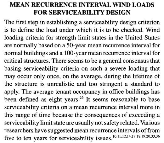

We've always used the 50 year for drift (i.e. 90 mph service wind) and this was, to me, an unwritten standard for many years.
The commentary in ASCE 7-10, for Chapter 26 (C26) discusses this.
Part of it all depends on the nature of the building (occupants, use, cladding, etc.) and is left to we engineer's discretion with very little to go on.
We've just leaned back on the 50 year unless we have struggles with that (usually don't) and then if we do we might look at something less onerous.
AISC had their nifty table that they published some years ago that dealt with drift limits related to exterior cladding (AISC Journal, 1st Qtr, 1993)
They also put this information in their Design Guide 3.
Here's a short snippet of their commentary on return period:
