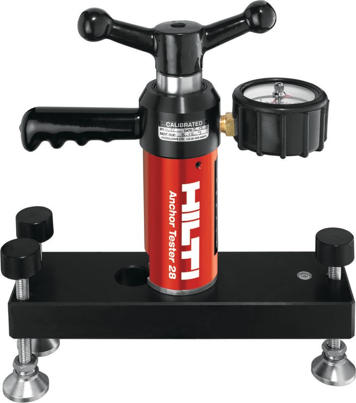

For smaller anchors we have 3 ton, 12 ton, 25 ton and 50 ton hydraulic rams, and for very small mechanical anchors, we have an older manual HILTI test unit, originally from Europe. HILTI sell this test unit in all markets except the US:
Simpson Strong-Tie no longer conduct field testing of their adhesive anchors - they leave the testing liability to others!

Ingenuity- From your pictures above, watch out with the first method shown. The jack will push down as much as it pulls up, impacting your break out cone. That is why the Hilti product shown in the 2nd picture has the legs pulled out.
That is why the first graphic it is called a CONFINED pull-test - it is NOT testing the pull-out cone, only the bond-related aspects of the adhesive/anchor.
To undertake an UNconfined pull-test, where the pull-out cone is applicable, you need a 'bridge' to span across the anchor, as per ASTM E488-15 STANDARD TEST METHODS FOR STRENGTH OF ANCHORS IN CONCRETE ELEMENTS or ASTM E3121-17 STANDARD TEST METHODS FOR FIELD TESTING OF ANCHORS IN CONCRETE OR MASONRY
