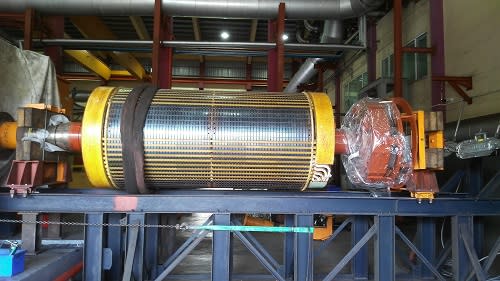

@Randhir
Could you post a photo of the rotor here? Use the 'upload link' green button above the comment box.

RE: Alternator rotor earth fault
Did it have metallic retaining rings over the end windings? I see only the insulation bandings, one of which is cut?
These are insulation bandings over the end windings.
The rotor is not new. it is in service since 2007
So the steel retaining rings have been removed prior to the photograph being taken? I can't imagine anyone building a rotor of that size and not needing retaining rings in the design, even on a four-pole machine where the rotational forces are much lower than on a two-pole design.
Scotty - I am guessing the diameter of rotor around 1.3 m. At that dia and speed and power, it has to have steel retaining rings. Insulation bindings not gonna cut it. OP has to post more info to help.
Well if you're right then that makes it nearly twice the diameter I'm guessing. smile I reckon about 800mm. Still way too big to avoid the use of steel rings, at least in the machine designs I'm familiar with.
If there's a shorted turn caused by winding movement due to centrifugal forces or thermal expansion then it may not be apparent until the rotor is at operating speed and temperature, with the fault going open-circuit at standstill and/or as the metals contract back to their rest positions. That will make fault location more awkward to say the least.
