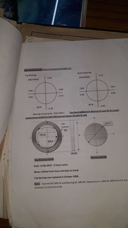

A vertical 900 KW, 600 RPM cage motor which drives a directly coupled cooling water pump below. The weight of the rotor assembly is about 2.4 tons.
The guide bearing area diameter on the shaft is about 309 mm at both top (ODE) and bottom (DE).
What is the recommended diametrical oil clearance for the guide bearing of this motor?
I normally follow the thumb rule of 1/1000th of the diameter = diametrical clearance for guide bearings. So, in this case it works out to 0.31 mm diametrical clearance. Is it correct?

The OEM, though still in business, has discontinued making this motor, which is more than 3 decades old. Zero help from them to the client, who also have lost track of original OEM manuals. Two motors came to us with severe core rub and winding failures. The guide bearings areas of the thrust collar in both the motors were badly damaged with scoring and rubbing damages. Apparently, they have had a history of such rubs. We had to remove about 1 to 2 mm of material on the OD of these guide bearing areas to bring back clean running surface. For now, I recommended to them to keep 0.1 mm radial clearance with newly babbitted guide bearing, which is not split and not adjustable. They can always increase this clearance based on the performance.

Thanks Pete. I have also read that Yung's piece and have also discussed with EASA about this.
As you say, heat is an issue with too small a clearance. The client is going with 0.1 mm radial clearance for now and I will know the performance shortly. If it is getting heated, they can increase the clearance.
The client's very old drawing of the top guide bearing.
