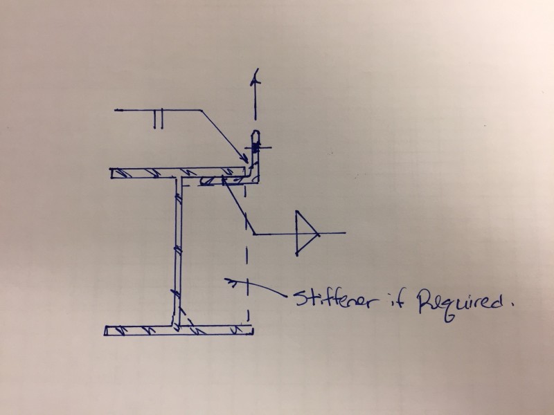

I have the "traditional" lifting lug design guide.
but in this case the lifting sling will go through the thickened web of beam all the way thru the other beam of this skid.
any design guide for this this type

Ns4u, can you provide sketch of what you usually use
RE: lifting hole on beam web
delagina, please see sketch. Could something like this work for you? Your sling will still come up at the same location with this method and it eliminates the sharp edges and having to feed your slings through the holes.

Thst can be tripping hazard though if not cut. And it needs to be long to be above the grating.
I should just weld lfiting lug on the beam top flangr instead thst would be simpler and field cut it instead.
I see, I misunderstood the nature of the tripping hazard you were trying to avoid. Could you move the angle to the bottom flange of the beam? Then you could put a shackle in the angle and then the sling would run vertical just past the edge of the top flange.
