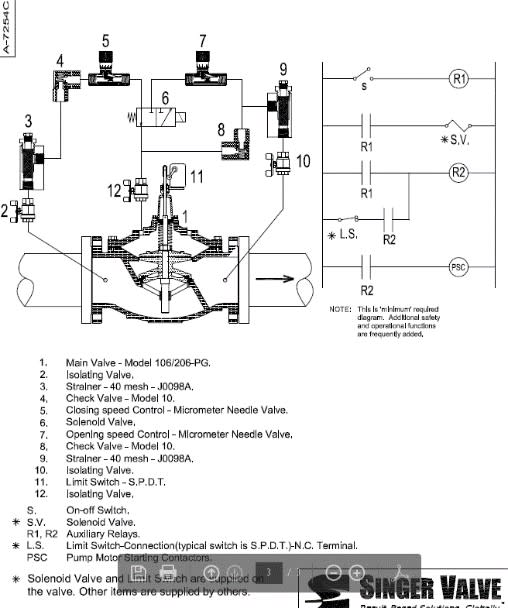

Can anyone point me to a general schematic of how this functions? I don’t necessarily need the actuators inner workings. I’m more interested in the connections to the system header. My specific situation is the application of a Pump control valve on a high service Pump. Thus I have (relatively) constant pressure on the distribution side and periods of no pressure on the Pump side. What I’m hoping is that the actuator will be connected to both sides, such that to shut the valve it will use distribution pressure and that to open the valve it will use discharge pressure, such that the valve won’t open if the pump isn’t generating an overcome pressure. Looking for a schematic that might illustrate this, or some other general working arrangement. Thanks in advance.
RE: Hydraulic Valve Actuator using System Pressure
It looks like in this manual there is only one water inlet into the actuator. Is there then a power unit somewhere to generate a pressure higher than that provided from the water system? That is, I’m going to need to shut the valve against system pressure, therefore I would need a pressure greater than system pressure to act on the valve actuator (the diaphragm in the case of the link provided). Or is it just a difference in areas, where the area to close the valve is greater than the area to open the valve, thus with an equal pressure acting on each surface, the force to close is always greater than the force to open?
I was hoping I could tap the upstream side of the valve for valve open and the downstream side of the valve for valve shut...so that in the case of pump failure, the valve wouldn’t be able to open. Is this common or would this be an extraordinary arrangement?

These valves work on line pressure. Solenoid valves are used to route the pressure to open or close the valve. The line pressure operates against a diaphragm. The operating force is based on the area of the diaphragm times the pressure. If you use a larger diaphragm on one side, lower pressure can be used to shut the valve against higher pressure.

It would help if we knew what you are trying to do? A standard pressure reducing valve opens with flow from the inlet (pump) when outlet pressure is lower than the setting of the pressure reducing pilot.
Pump Control Valve for a high service pump (pumping into distribution system).
It's a ball valve, similar to attached sketch.
Client has requested that the actuator operate using system pressure.
There will be no check valve and no pressure switch talking to the control valve.
I have currently designed an interlock so that if the pump "fails to start" the valve will emergency shut. What I'm trying to protect against now is the remote case of motor starts but pump isn't pumping (sheared shaft, etc.). I want to make sure the valve doesn't open. So what I'm proposing is that instead of a standard 4-way solenoid (inlet, valve open, valve shut, drain) there may be two 3-way solenoids whereas pump discharge pressure is used to open the valve and system pressure is used to shut the valve. I've updated the sketch to reflect what I think the end result will need to be and reattached it here. I should have it figured out next week and will let you know I came up with.

"Pump discharge pressure is used to open the valve and system pressure is used to shut the valve" describes a standard pressure reducing valve that does not require electric actuators. You can also add a check valve feature to the pressure reducing valve for an all in one valve.

Thanks all for your responses. I have determined that a valve control system very similar to the standard pump control valve that bimr posted, is what we will likely do. We are using a ball valve because it's important that we be able to control the opening and closing speeds whereas a check valve will not allow as much control. What we're wanting to do is to replicate what the Singer valve would do, albeit with more control over the opening and closing. It's a standard application (ball valve with hydraulic cylinder actuator) with a small change to get hydraulic pressure from two different places. Thanks to all for your contributions.
