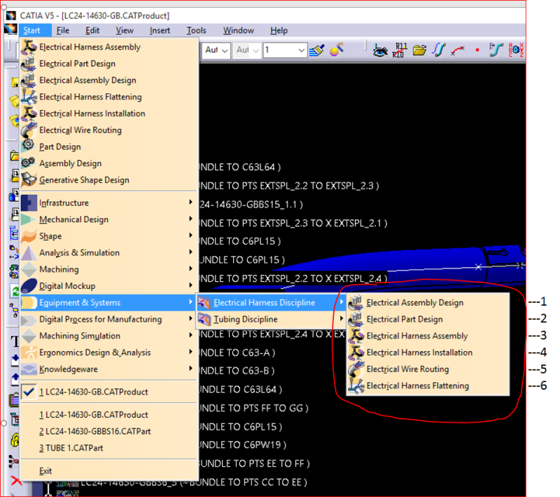

Below is a different way to formulate the question of this thread:
Automotive Catia Electrical Harness Design Workbenches - Usage
I am involved since January 2017 in Catia Electrical Harness design ( I had no prior experience in this area before January 2017).
So far, I haven't use other workbenches except Electrical Harness Assembly (#3) and Electrical Harness Installation(#4).
Am I missing something? How about the other 3 workbenches?:
1) Electrical Part Design
2) Electrical Assembly design
3) Electrical Harness Wire Routing
When should they be used, why they were not required in all the assignments that I was asked for so far?
I am a little bit confuse......
CAD 2015
RE: Electrical Harness - Multi-Branchable Document vs Bundle Segment
1. EAD - to create assembly between electrical parts. Let's say you have a plug and a socket, you could connect them together using electrical properties.
2. EPD - to create electrified part. For example the connectors that you are probably using from a library, are electrified with EPD.
You cannot properly link bundles to not electrified parts.
Above two only to be used only if you are creating the library with connectors for example.
5. EWR - it is possible to define individual wires between connectors.
I'm using it only for checking of the network, if all connected properly to connectors.
Using a local tool, it is used to compute bundle diameter based on diameter for each individual wire.
6. EHF - it should be clear, it is used to flatten the bundle for manufacturing
99% I'm using only EHA and EHI but I'm interested only in the mechanical part of a bundle :)
