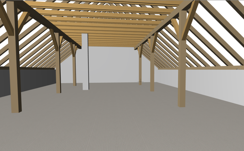

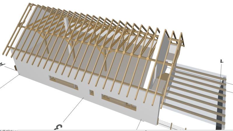

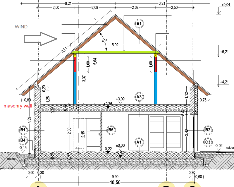

Hello. This is not my field so I hope for some help and suggestions.
My question: Is this timber roof horizontaly stable (in case of wind/earthquake forces)?
In longitud. direction I know this is stable since we have knee braces + sheating on top of rafters that transfer forces to longitudinal walls and RC slab.
But what in other direction? Walls are masonry + RC ties. I dont want any bracing between columns (in vertical plane) because I need space between.
In attached file:
rafters - brown
knee braces - red
column/post - blue
longitud. timber beam - yellow
collar tie - green

It can be... depends on connection design. Framing is common to 1000 timber framed barns. Tie the roof into the end walls.
If you raise the interior columns you get the classic Gabriel roof line.

Agreed. A skip-sheathed roof diaphragm could be dicey, but plywood could be no problem.

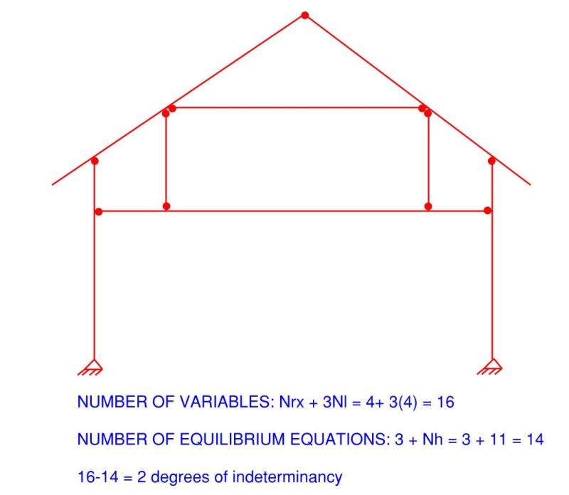

It is an indeterminate, stable structure.
Nrx = number of support reactions = 4
Nl = number of closed loops = 4
Nh = number of hinges = 11

The structure as illustrated, relies on the masonry walls in bending to resist lateral loads. It also relies on connections at various points.
Edit: Adding braces between the brown and green members as suggested above, does nothing to change this.

I disagree with BAretired. If there is roof sheathing, the lateral load is resisted by the roof and the floor.
DaveAtkins
RE: is this timber roof horizontaly stable?
DaveAtkins makes a good point. If the roof and floor deck are capable of behaving as diaphragms spanning the full length of the building, lateral load could be resisted in that way, but the structure, as illustrated, relies on bending of the masonry walls.
