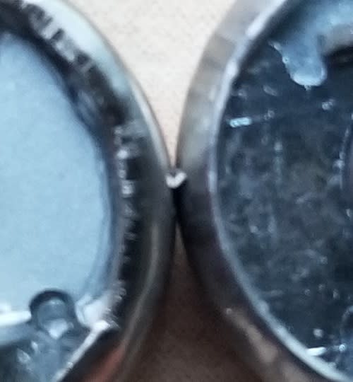

RE: Metal coating for soldering?
Hi All,
I was looking at the surface finish of the piece of zinc coated metal. I have one piece with a matte finish which solders fine, but the one with a more polished finish is the one which started this thread. Matte = solders OK, polished = solder does not stick as well.
I did a quick test and used low grit sand paper to abrade the polished surface. I then heated the surface and applied solder. The polished surface created a more bulbous solder ball while the sanded surface looked spread out more- better wetting. I think my issue may not be the zinc itself but an actual surface finish issue. I think the matte surface has more surface roughness therefore is better for soldering.
Matte finish on the left, polished on the right
Thoughts?

For Zinc coated steel, either galvanized, or electro-Galv you will need to use either Hydrochloric/muriatic acid which reacts with the zinc to form zinc chloride flux, or a proprietary acid soldering flux which contains free acid. The standard Rosin type fluxes have very poor performance on zinc coated parts. The soldering on the zinc case needs to be done away from the PCB to avoid acid flux contamination, once you have tinned the zinc pigtail with solder, you will then need to neutralize the soldered pigtail before coming back to the PCB, which you can then solder with a rosin core solder on the " Tinned" part. So tin the zinc part first , clean and neutralize it then assemble your PCB as before.
B.E.
etang858
Ok two things, the non wetting of zinc plated or galvanized material is a function of the flux, you cannot easily solder zinc without a chloride flux .
If you paint the zinc where you want to solder with Hydrocloric acid the zinc will start to bubble, this is the acid cleaning the zinc and turning into zinc chloride, the flux you want. You can then solder this with either tin lead solder or 95/5 lead free solder, use a big enough iron to ensure you have thoroughly wetted the part. The zinc peeling off sounds like electrogalv zinc, what you need there is enough heat to reflow the coating. Now this is important having done this, you have to, clean the part, and neutralize the acid flux,( baking soda) before, you get that PC board anywhere near that.
You were saying you need to store these panels this would be a good time to do so.
Then for the second stage you can assemble the PCB onto the panel, however you may have to use a larger iron than the standard 25watt iron because of the size of the steel part, but use the rosin core solder or add rosin flux.
B.E.
