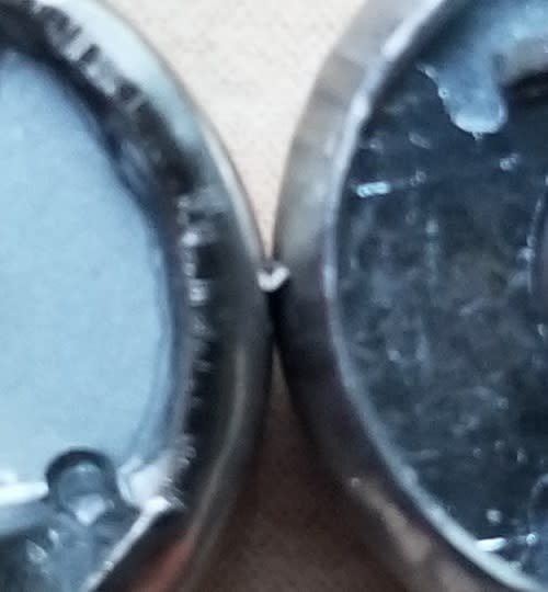

Hi All,
I was looking at the surface finish of the piece of zinc coated metal. I have one piece with a matte finish which solders fine, but the one with a more polished finish is the one which started this thread. Matte = solders OK, polished = solder does not stick as well.
I did a quick test and used low grit sand paper to abrade the polished surface. I then heated the surface and applied solder. The polished surface created a more bulbous solder ball while the sanded surface looked spread out more- better wetting. I think my issue may not be the zinc itself but an actual surface finish issue. I think the matte surface has more surface roughness therefore is better for soldering.
Matte finish on the left, polished on the right
Thoughts?
