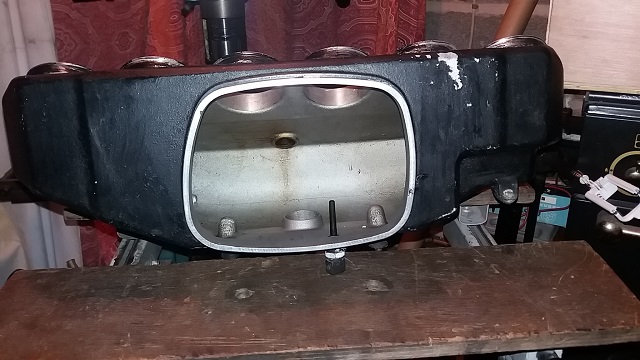

I've noticed something glaringly obvious.
My six-cylinder engine is effectively two three-cylinder engines with a common crankshaft.
Cylinders 1-3 have a common exhaust manifold as do cylinders 4-6.
The intake has individual throttle bodies with all six cylinders have a common plenum.

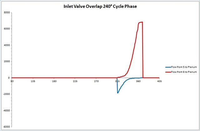

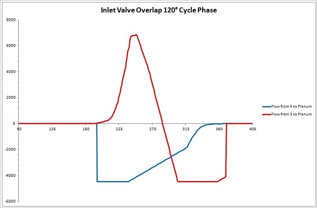

A six-cylinder has a cycle phase of 120° and because the inlet valve has a duration of 293°, there is a 173° overlap.
Graph showing six-cylinder inlet valve interaction
In the linked image, the red line shows the cycle that is following the blue. Positive values show "air" moving from the cylinder into the plenum, negative values show "air" moving from the plenum into the cylinder. You can see that some "air" would move from 3 to 5.
The firing order is 1-5-3-6-2-4. 1 & 5 are four cylinders apart and 5 & 3 are two cylinders apart. This means that 5 will influence 1 less that 3 will influence 5.

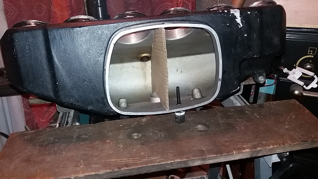

To almost eliminate this inlet valve interaction, I propose to split the plenum in two. As the phase is now 240°, the overlap will be only 53° and the flow from consecutive cylinders would be significantly reduced. Here is the inlet valve overlap graph...
Graph showing three-cylinder inlet valve interaction
The proposed modification...

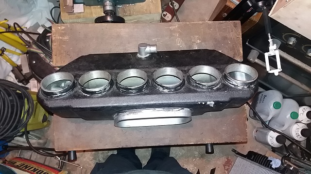

Plenum before...
Image of unmodified plenum
Plenum after...
Image of modified plenum
I'll replace the cardboard template with aluminium sheet and secure it with epoxy resin.
Do you think this is a sensible thing to do?

It depends. It would be good to understand the OEM designer's rationale for doing it the way they did, and deciding from there why and how to modify.
Plenum volume has a role to play in volumetric efficiency as well as throttle response, so you should understand what trade-offs were made in the OEM design in these areas before you proceed with modifications.
Keep in mind that volumetric efficiency, not to mention throttle response, is highly rpm dependent, so you need to have a goal in mind for your torque curve, and accept that the torque curve is directly influenced by VE as a function of rpm.

It is likely that your mod would improve WOT while hurting part throttle and lower end performance.

Intake overlap doesn't cause the behavior your plots say it does.
I don't have your equations to do the math that generated your chart. Where did you come up with this?
If you're plotting flow rate vs time (which you are, using cylinder angle as a proxy for time) than the integral (the area under the curve) of the plot will give you the total flow. Since we don't have access to the math you used to create these, we can only evaluate visually- but from the plots you've created it appears that your model shows Cyl 3 taking in very little total volume over its whole intake cycle. (area under the positive curve minus area under the negative curve looks like a very small number).
This is not how engines work.
Intake reversion is certainly a thing that can exist- and it will continue to exist until someone comes up with a valve actuation system that is continuously variable and universally applied. But the amount of reversion that actually happens is small, and only happens in certain parts of the RPM range of an engine. The true fix for reversion is porting; basically, reversion is caused by restrictive ports which don't allow the intake air to keep velocity through the port throat. Porting the cylinder heads in a way that improves low-valve-lift intake flow fixes this problem.
On top of that... The modification you've pictured takes the plenum opening and cuts it in half. Any cylinder with an open intake valve is now drawing air through an opening that is half as big as it was. This is bad. The point of having a large plenum volume is that it provides dampening for pulses created as the valves open; reduce the plenum volume, and you reduce the damping. That's also bad.
In short, don't modify the plenum. Leave it alone. If you want to make the most power possible, remove the plenum entirely and put a filter on each throttle body. This, in effect, gives you a plenum of infinite volume.

I've only shown the intake overlap period as that is the period when the cylinders interact.
The maths that I used was the in-cylinder pressures from here and the minimum between the inlet valve curtain area or the most restrictive area in the inlet valve throat.
Inlet valve curtain = pi * 35 * valve lift * 2 (35mm valve head and 2 valves)
Minimum inlet throat area is around the valve stem. By measurement, I estimate this as 333 sq mm in each intake valve throat, so 666 sq mm because there are two valves.
By estimated measurement with a tape-measure, the plenum is 10,000cc and the "scoop" to the MAF is 1800cc. The "scoop" will remain standard. The engine is 3201cc (each cylinder is 533.5cc) and max rpm is 7650rpm.
I understand (and agree) with the dampening comment, but the way I have looked at it is...
Firing order is 1-5-3-6-2-4. If you split the plenum into Left and Right plenums...
1-LEFT
5-RIGHT
3-LEFT
6-RIGHT
2-LEFT
4-RIGHT
Rather than using a 10 litre plenum to feed six cylinders, I would be using 5 litres to feed 3 cylinders. In theory, the new plenum is 9 times bigger than the cylinder.

So you produced that plot by hand-calculating valve flow?
Using what pressures?
You're basing a lot of things on a port flow chart that is not accurate.
Your chart indicates that air is flowing OUT of the intake port for nearly 90 degrees of crank rotation. It also indicates that the peak flow rate of air being pumped back into the plenum is higher, by 50%, than the peak flow rate of air flowing into the valve later on.
This chart is nowhere near realistic. You should throw it away and start over, instead of using it to make decisions.

jgKRI - I've expanded the graph to show all 720° and the net intake value is obviously wrong hammer.
I need to have another think about this.

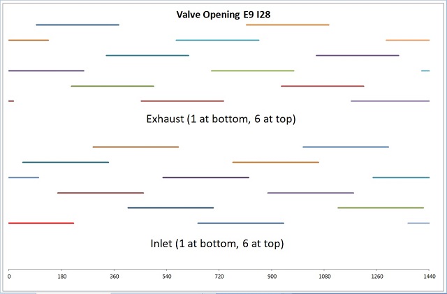

I've done the analysis of the valve timings. The timings are different for each variation of the VANOS* angles. These timings are for a VANOS position during a 0-60mph test
At least 2 inlet valves are open 100% (720°) of the time.
At least 2 Inlets PLUS an overlapping exhaust valve are open 73% (528°/720°)
Only 3 inlet valves PLUS an overlapping exhaust valve are open 44% (318°/720°)
Cylinders 1, 2 & 3 in isolation...
2 inlets PLUS an overlapping exhaust valve are open 22% (159°/720°)
Cylinders 4, 5 & 6 will be the same as 1, 2 & 3.
*VANOS is the variable cam system
Valve Chart
Each line represents the period the valve is open.
Inlet#1 is the bottom row, Exhaust#6 is the top row
The left end of each line is when the valve opens, the right end of each line is when the valve loses.

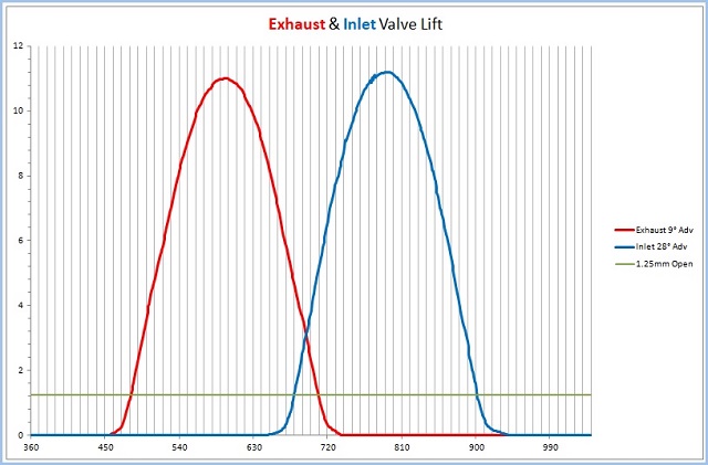

I agree with this ATDC, but from approx 70° BTDC, the inlet valve is open and the piston is rising. From around 70° BTDC, the exhaust is closing, the inlet is opening and the piston is rising.
I think there is the possibility that "air" at 23psi in the cylinder could choose the 15psi plenum over the exhaust as the easiest exit.
This "air" could have the positive effect of pressurising the plenum, or the negative effect of disturbing the flow of air into the cylinder that is 120° further through its phase.
Valve Lift Chart showing opening/closing times (720° = TDC)

Once again- you're neglecting velocity and the inertia of the air in the port. The system is not static- if you try to analyze it like it is static, all of your conclusions will be incorrect.
You seem to be of the mindset that 'it's just air, how fast could it be moving'. This is a common line of thought in the minds of people who have never done a deep dive into cylinder head design.
Well.....
Your car's S50B32 makes approximately 320 brake horsepower.
From that number we can directly approximate the amount of air the engine consumes- this works out to about 220 cubic feet per minute for 320 bhp.
220 CFM x 28316.8 cc/CF = 6,229,696 cc per minute. That's roughly a cubic meter every 10 seconds, or 100 liters per second. We're talking about a LOT of flow here.
6,229,696 cc/min / 60 s per min / 12 ports = 8652.36 cc per second per port.
Given your flow area of 333mm2, this gives an average port velocity of 26 m/s.
But that's just an average- the intake port is actually only open about 40% of the time (290/720).
Average port velocity for just the time the port is open is 65 m/s. That's almost 150 mph, and that's just the average for the time the valve is open!!!!!!! That velocity takes time to build, meaning that the true peak velocity in the port is much higher.
The cylinder pressures are not high enough to slow down this high speed jet of air, stop it, and accelerate it in the other direction.
It is not just about pressure- you cannot neglect the inertia of the air in the port. It is massive.
The air in the cylinder is also a compressible fluid. When the piston starts back up, it is accelerating. These components are moving VERY fast- so fast that the air pressure exerted on the face of the piston is not the same as the local air pressure in the flow area of the valve.
This is a high speed machine. You can't evaluate it by disregarding the kinetic energy of the moving parts- and that includes the air being pumped.
