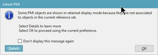

RE: PMI visibility in drafting
Hi Ivan,
I don't agree with you
I know this process, but I you don't use Entire Part, you will have the following message:

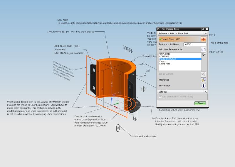

Then you have to set OBJECTS that PMI is linked to to model ref set. PMI is not part of ref set, but they are connected to model so if you removed parts of model form Model ref set, that is why you can't see PMI. PMI works without ref.set if all objects that have PMI are in model ref set.

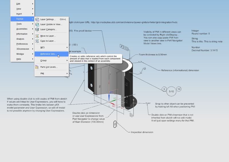

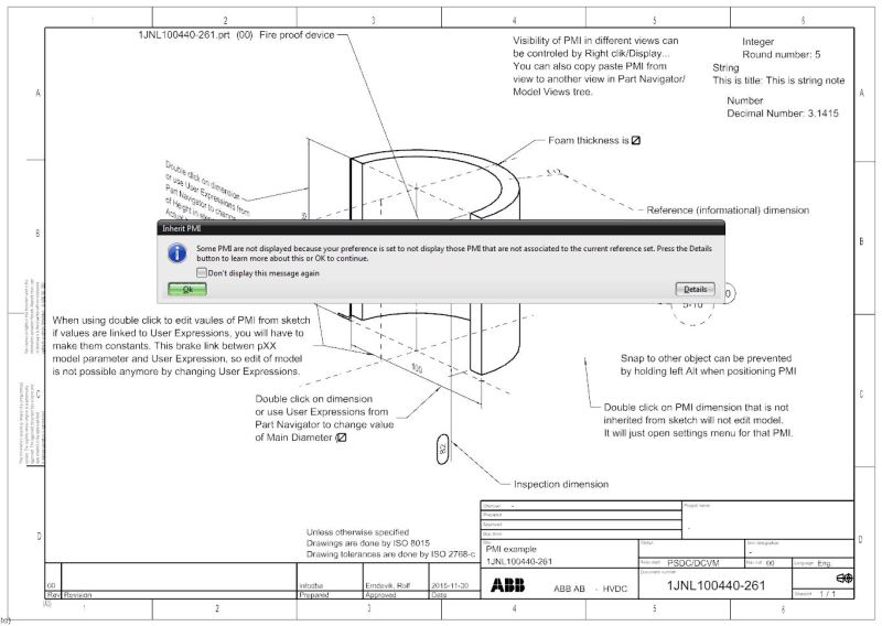

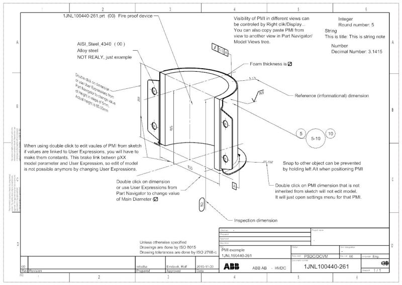

If you have model with all objects with PMI in model reference set
Then drawing looks like this
But if you remove one solid body from model reference set
Then you get that error message (either on update or in your case on view placeing)
So go to reference sets in your model, and make sure that all objects that have PMI conneted to them are in model reference set.
After thinking a little, I think that you have sketch that is stand alone, so it does not make body, but it have PMI connected to it (bodies are by default set in Model refeernce set, but sketches are not). You should add that sketch to Model reference set, so you do not have to use Entire Part.

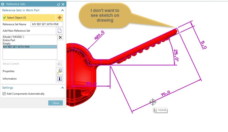

Hi Ivan,
You are right, I am taking about standalone sketch. And in this case I know the process and I should use ref set or entire part.
But I am obliged to hide the sketch in the Master model to avoid see it in the drafting :( Other idea ?
