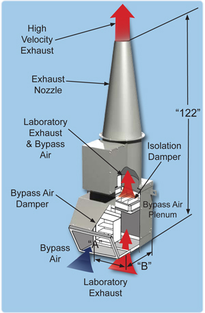

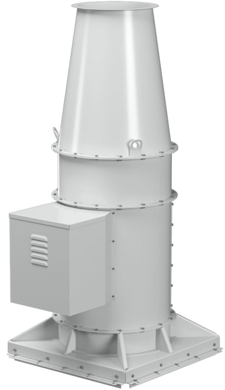

I suggest you get a nozzle system going then. Silicon Valley has some noxious exhaust you never want to get back into a building. What they frequently do is put a small blower on the roof at the base of a duct nozzle. The exhaust ends up leaving at 30MPH vertically.

The solution proposed by Keith is expensive and really intended for lab exhaust.
