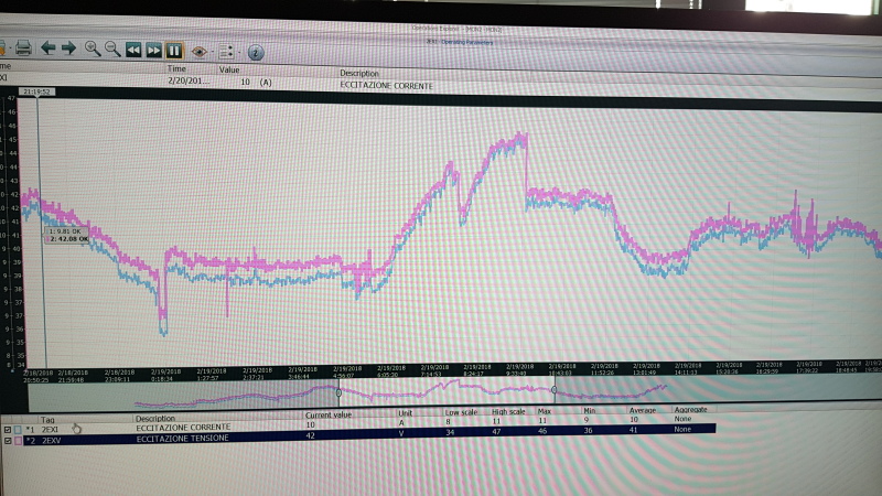

I made Mistake because the system with the problem is a GAS turbine and Not Steam Turbine.
Anyway i show you a sample of the problem.
on the image there are very few little problem (sorry i'm new in this plant so i don't know yet how to load previous data in long time) but consider when the problem is present the voltage fluctuations are more and more.

Looks like voltage on a transmission system. I can't read the vertical scale to know for sure, but that looks pretty ho-hum to me.

What is the time base? Minutes?, Hours?, Days?

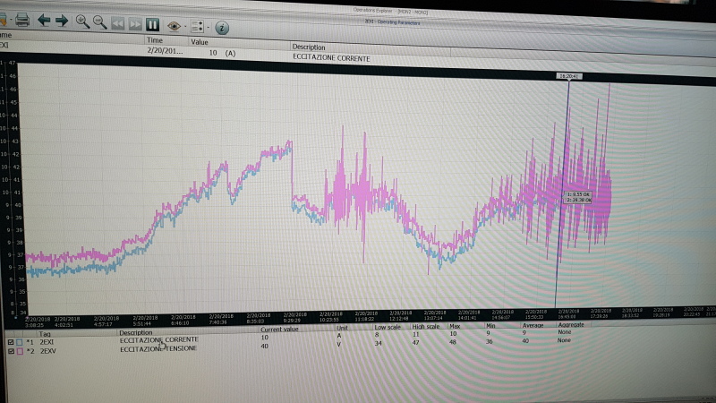

RE: Unitrol 6800 static exciter voltage fluctuation
Probably this is clearer.
Voltage scale min 34 - max 47 Volts
Current Scale min 8 - max 11 Ampere
Timespan is from 3 until 17.30

If that's field currents and voltages we still don't know much. What does the generator output look like while this is happening? Terminal voltage, real power, and reactive power would provide a more meaningful story. Is there a PSS on the unit? They can cause lots of activity in the field that doesn't appear as readily in the stator.
I'm still inclined to think that you're looking at the AVR's response to external conditions rather than seeing the AVR cause trouble. Part of that is based on assuming that "National Electric Company" implies a large stiff system. If this unit is a significant portion of the total capacity then other conclusions could be drawn.

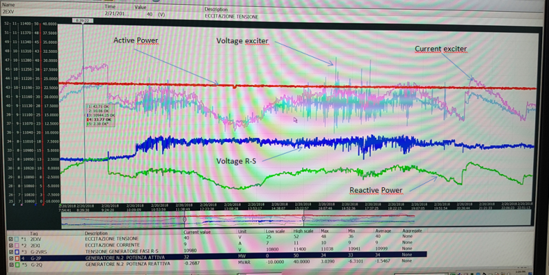

Davidbeach, i don't know really if PSS is present in the unit and below a picture about problem and in attachments you found layout of the plant in order to give you much indications as possible.
I don't know exactly where the problem cause reside and i'm open at every considerations. The active power of the system still constant because forced by active power of other (stibilized .. but i'm not sure).
looking at generator voltage it is possible to see it follow exciter voltage drops.
What did it look like 6 weeks ago? What did it look like 6 months ago?
What is the generator control mode?
What are other units in the plant doing at the same time?
What evidence, not traces on a screen, is there that this is a problem and not just a normal response to beyond the GSU system dynamics?
You may have a real problem, but I've seen those types of traces with that much, or more, noise on the exciter channels where everything is just fine. Throw a PSS into the mix (a unit that size would almost certainly have a PSS here) and the signal gets even noisier looking.

Looking at the voltage scale on the Y axis, the voltage disturbance at the machine terminals is not large. There's an approximate correlation between rising reactive power export, with a corresponding drop in terminal voltage, in response to which the AVR increases the field current. If there's a PSS in there then the whole thing becomes considerably more complex. In the UK I'm not certain that we'd see a PSS applied on a 30MW set.
I'm not familiar with the Unitrol AVR but I wouldn't worry too much about the exciter voltage: the field current is almost certainly the controlled variable in the AVR's inner control loop, not the voltage. The voltage will swing significantly because of the highly reactive load it is driving: remember E = -Ldi/dt ? The AVR is trying to rapidly vary the current in a highly inductive load - it's entirely normal for the voltage trace to be a bit lively.

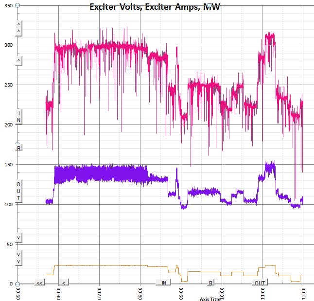

For comparison, attached is an image of 25 MW hydro unit showing exciter fluctuations of a similar magnitude.
One kind of odd thing about your graph is that the exciter had a large step response at 9:24 with almost no variation in voltage, but then both the voltage and the excitation increased at 10:09. Does the voltage control scheme change throughout the day? Does each generation regulate it's own low side bus or is there any sort of remote bus/line drop compensation?

@davidbeach
The new exciter was installed on 2007 and i'm not sure if this evidence was present at that time but the indication seems starting from last Agust (2017).
Regarding the Turbogenerator 1 (exactly same of TG2 with the problem) the exciter is exactly the same (ABB unitroll 6800)but there are no fluctuation in voltage either in Generator voltage.
Regarding your request and dubt about the graphs instead of real evidence, i'm agree with you some time some noise can add to signals but... why the TG1 have no signals? i Think i need to inspect...
The ABB made some check 2 weeks ago in order to verify the correct functionality of the system. Channel 1 (so driver 1) have no problem and Channel 2 (so driver 2 ) have no problem too.
In attach the graph show you differences about TG1 and TG2, can you see fluctuation on generator voltage (tensione) ?
