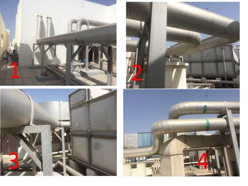

Air trapping through suction pipe when switch off the condenser pump. During switch off all water reurened to the cooling tower, Cannot be possible to change the piping configuration. Thinking an idea by fitting NRV closed to cooling tower outlet pipe to hold the water in suction pipe during the off period. Pipe size 16 inch. Any other suitable ideas…find the approximated sketch

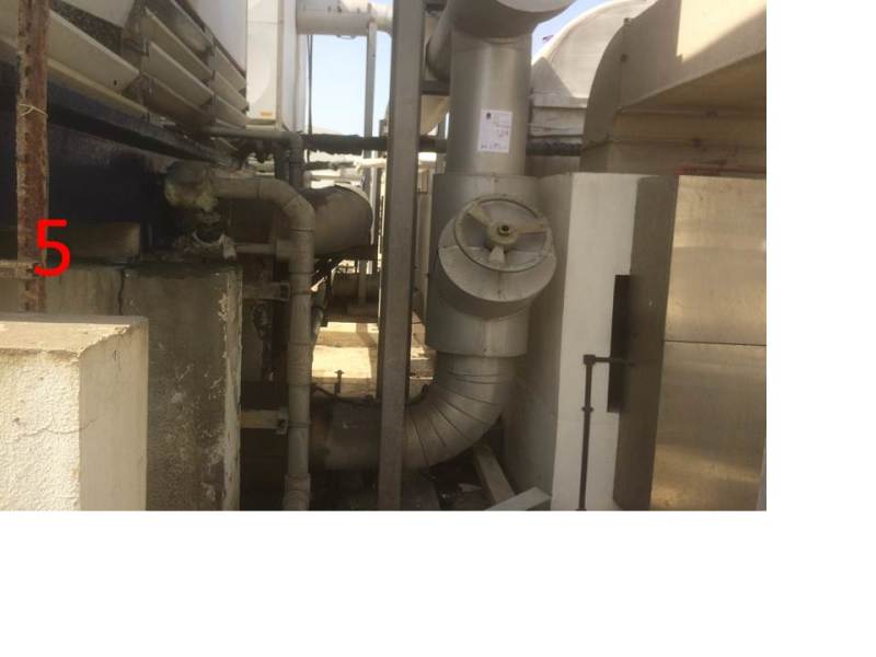

The suction pipe routed to cooling tower l like serpent. See the attached pipe images taken from outside the plant room. Right now, the condenser pump is running without any problem, but when switch off part of the maintenance, suddenly air is trapping to the suction pipe and as per the site info, the water will reach to the cooling tower and overflowing.

RE: Air trapping through suction pipe w
Lovely photos, but do nothing to establish what the problem is. A lot of expertise available to help, but very little crystal-ball experience.
At the moment you are wasting your time as well ours and as LittleInch has advised, DEFINE the problem.
