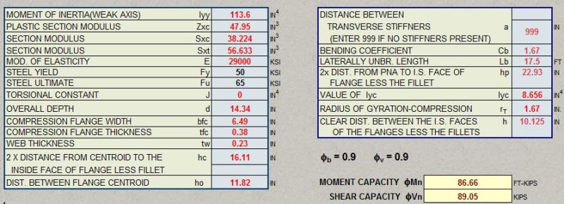

For positive bending (top of shape in compression) I get a ΦMn = 179.8 ft-kips (vs. 139.5 for the W12 alone)
For negative bending (bottom of shape in compression) I get a ΦMn = 86.66 ft-kips (vs. 139.5 for the W12 alone)
So for the negative bending of the combined section - I agree that the capacity is less than that of the W12 by itself.
But it seems to me that because of the drastic shift in the centroid, and the PNA, you have a little compression flange far away that could be more susceptible to LTB failure than the W12 shape alone.
So I'm not sure you can just ignore the combined shape effect on LTB.

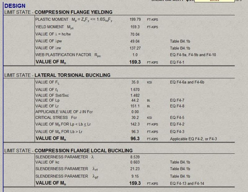

Composite - Sxc = 38.2 , Stress = 17.7 ksi
Stand alone - Sx = 33.4, Stress = 20.3 ksi
Quote (JAE)
Interesting, I got 74.6 ft-k and 113 ft-k

50. I get Fl = 32 ksi, not 35ksi. Sxc = 38.2, Sxt = 59.6
RE: LTB of Wideflange with Wideflange Cap Plate
Oh shoot. I was using Sxc / Sxt to get FL. Not Sxt / Sxc. But that still doesn't explain the discrepancy in our W12 standalone calcs...
It might be some of the input variables...not sure.
Here's the input I used:

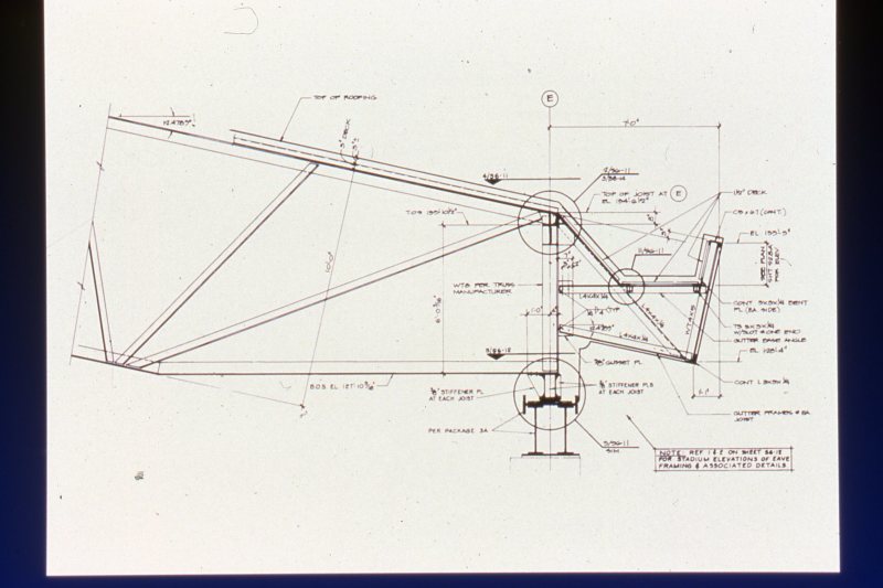

This section reminded me of the eave beam detail we devised for a domed stadium some years ago - we used three W24's - two vertical and one "cap" on top.
The idea here was to create a slot where the entire roof would skirt along on teflon bearing pads. The sections spanned about 21 ft. if I recall.
