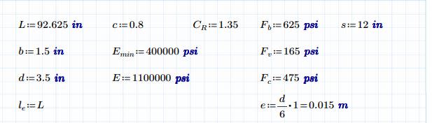

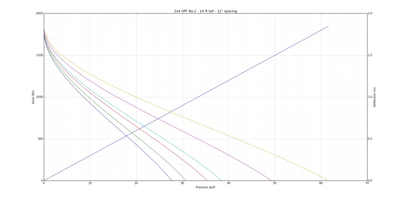

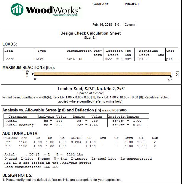

So I decided that I no longer wanted to be beholden to Woodworks etc and I would make my own stud wall MathCAD sheet. Go me. I wanted it done differently than what I see most folks do though. I wanted to generate interaction diagrams so that, for given project, I could just generate the diagrams for the handful of wall types that I'll use and then pick values from the graphs as needed. The graphs below do this I think. Each line is a different duration factor (0.9,1,1.25,1.6). They are for 2x4 stud grade 92.625" long; wind (psf) on the x-axis and axial (plf) on the y-ais. I've attached a printout of the entire worksheet for the ambitious.
I've spot checked some results and they seem to be okay. What's bothering me is how straight these curves are. The only action is at the top left in the first diagram where things get curvy with low levels of wind pressure. If you include minimum axial eccentricity of d/6 like software often does, even that goes away. That's what's shown in the second graph below.
So my question is this: does anybody have enough experience with wood stud wall interaction diagrams that they could confirm or deny if the results I'm getting look nuts. Considering how straight the lines are, I would have thought that NDS would just simplify the equations to suit. Frankly, if it's this linear, I feel pretty silly for even going to the trouble of making this spreadsheet.

Your diagrams look accurate to me if your using wind pressure then with a weak horizontal pressures your likely going to be governed by the axial - DL+LL combination at the higher pressures your getting into being governed by the DL+0.75LL+0.75WL case pushing you to NDS 3.9.2 for the interaction which I believe is pretty close to a straight line interaction as only the compression strength term is squared, maybe also explains the abrupt dip from pure axial to first bending case.
do your charts take into account plate crushing or the 5 psf minimum live load pressure?

Thanks for the feedback Celt. No plate crushing or 5 psf although I plan to add those once the base model’s up and running. Deflection too.
Presently, the graphs don’t even include load casing as I’m setting it up as a pure capacity monograph. The only load parameters in there are load duration and repetitive member.

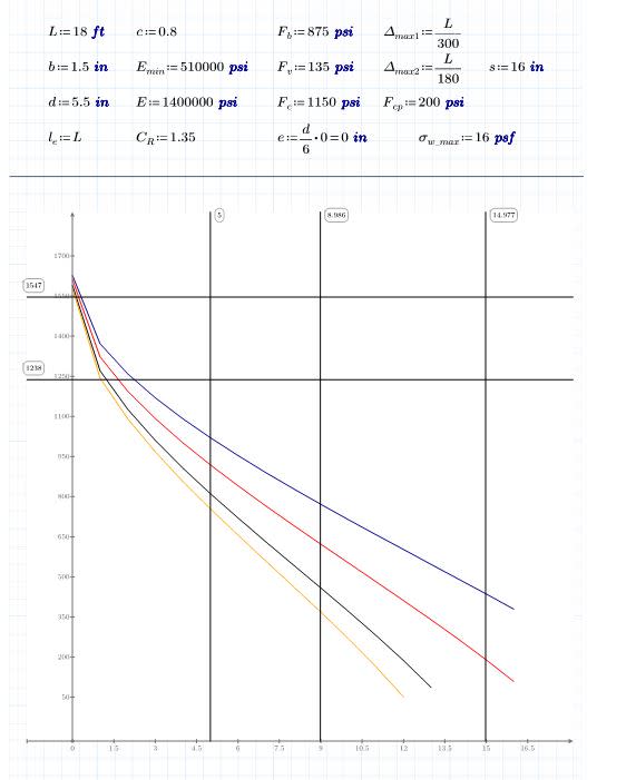

Revised version below. Things to note:
- Added some vertical marker lines corresponding to 5 psf and a couple of user defined deflection limits.
- Added some horizontal marker lines corresponding to sill plate crushing and sill plate crushing with the 1.25 increase.
- Tried out a long 2x6 SPF per Charlie. Same trend. Utterly liner if I put the d/6 eccentricity back in there.

We may get there but, first, I want to vet my output some more to make sure that it's not a KootK thang.

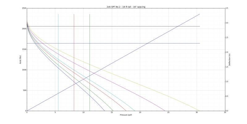

Some questions about your graph:
1) What condition does the diagonal line represent?
2) The defection scale on the right. Mispan deflection due to load eccentricity? The graph itself doesn't seem to include that.
I want these sexy features for my graph but first I need to figure out what they are.
RE: Interaction Diagrams For Wood Stud Walls
The diagonal line is midspan deflection for the lateral pressures only.
Top horizontal line is plate crushing with Cb applied. Bottom line is plate crushing where Cb=1.
Vertical lines are l/360, l/240, l/180 deflection limits.

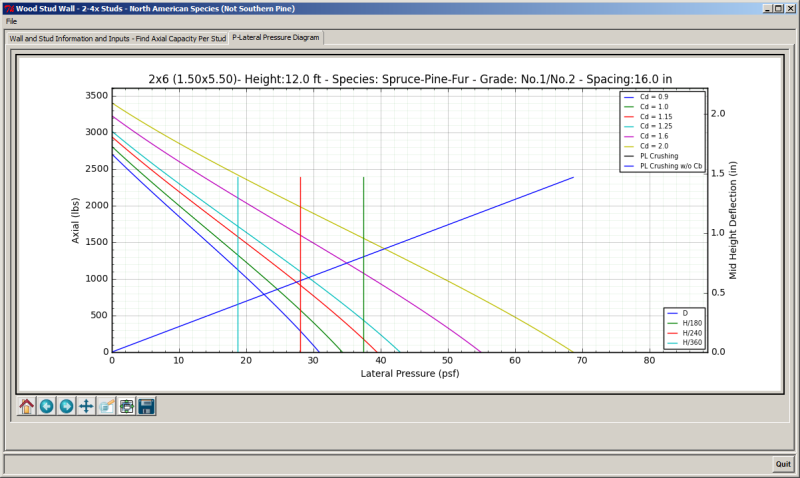

Basic GUI is functional will be adding the interaction graph to the second tab. The GUI is setup to calc the axial capacity based on the shown inputs. There isn't a whole lot of input validation so be mindful of inputs.
added Fv and Fv' calcs to the base wood wall class
here is an example of what the GUI looks like:

OK the GUI now has the full charting functionality.
I'll stop flooding the forum with update posts now, I plan to keep tweaking this check the commits on github if your interested as it will highlight what lines I've changed and I personally like to include comments with each commit stating some change log info:
Hopefully Near Future updates:
-give additional results information like the stresses, interactions, detailed Cp calculation steps in the results text box and give it horiz/vert scroll bars so you can see all the info
-Add the ability to save all the user inputs and open a file with those inputs
-Write out a results text file - likely comma separated for easy import into excel
-plot the deflection with the eccentricity considered and solve for the P-M combinations that yields each deflection limit so those vert lines fall in the proper location on the chart.
-Input validation - ugh not my favorite process
The plate crushing horizontal lines will only show up if they are less than 20% greater than the maximum axial load with Cd=2.0

nice
Looked thru your PDF Sticks couple questions:
CL your calculating a value here but the bracing assumption for the stud wall sheathing satisfies the criteria to consider a CL of 1.0
Looks like you've got a second interaction check of (fc/Fce2)^2 + (fb/Fbe)^2 any reason or reference for doing this interaction?
Open Source Structural Applications: https://github.com/buddyd16/Structural-Engineering
Celt,
I am not a wood person, so I am having this sheet reviewed our wood people as well (they seem to like it so far).
I appreciate the 2nd set of eyes.
In my beam bending design where I calc'd Cl, I was assuming that under a suction load, compression would develop on a face that I did not know if it would have sheathing. Therefore I calc'd Cl. Is this atypical in wood design assumptions? I counted on the sheathing to brace the stud in the column calculations for out of plane buckling.
With regards to your second question, "(fc/Fc)^2 + (fb/Fb)^2 any reason or reference for doing this interaction?"
This was actually a typo of equation 3.9-4 and me getting lazy (not checked in my current setup). Equation should be (fc/FcE2) + (fb1/Fb)^2 < 1.0. Does this equation control in your experience? I might need to add it to the sheet if so.
Thanks,
S&T
the CL factor has a pretty decent impact on strength - to the tune of 1,000 lbs+/- per stud with a 2x6 wall
Notice also the significant impact to the Cd = 1.6 and 2.0 curves
braced - CL = 1.0 :
Unbraced:
