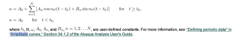

Hi there,
You can apply an amplitude defined as periodic on any type on boundary/loading conditions.
Tools>Amplitude
It is really flexible to simulate any cycle.
rgx
