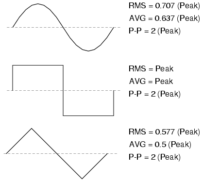

When I was in the college one of our professor while explaining the form factor for the pure sinusoidal wave he was mentioning that this factor is used as the basis for selecting the voltage levels.
Form factor = RMS Value/Average Value
For the pure sinusoidal wave, Form factor = 0.707/0.637 = 1.1
So the average voltage value is in the multiples of 10.
But in reality, I don't find any application of this. But due to the usage, I am now habituated to these multiples of 1.1, as I am in IEC world.
