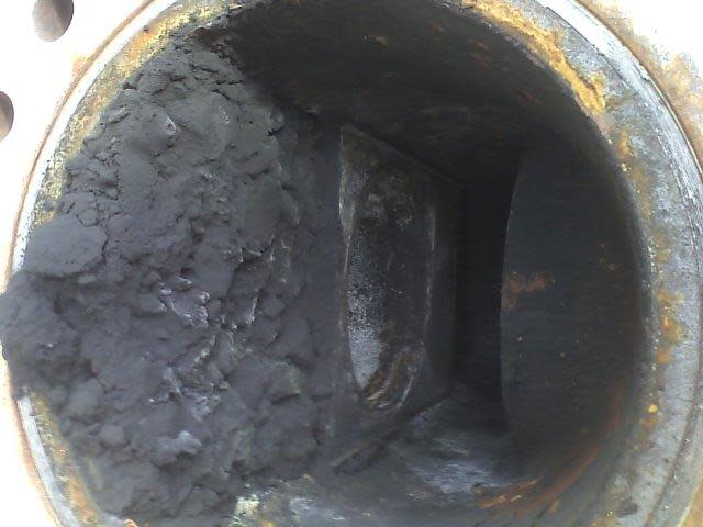

RE: On/Off valve for syngas service
Is this similar with your dust?? the valve size is 8"
Even tough it is possible, I am a bit skeptical to use ball valve for two main reason:
- there is a micro gap between Ball and seat (that's why break to open/close torque is almost always bigger than run to close/open torque). The micro dust (not yet accumulated) as pictures above might be caught between this gap, and once operated it will scratch the sealing area. And this is prone for any common industrial hard facing such as TC, Stellite, etc.
- the size is DN 50 or DN 80 as you mentioned. Making it trunnion mounted with tight shut off requirement is a challenge, and making it with extra scrapping device would be an extra challenge. basically scrapper is an extra "relatively sharp tip" on the seat to remove the dust stuck on the ball surface.
Having said that, yes it is possible. But it would be really expensive and requires time to make one. Time = once these ball valves fail again, you will be depending on the manufacturer to provide similar design in a rush manner. Price is driven by the manufacturer.
Some good ball valve manufacturer for severe application ValvTechnology, MOGAS, etc.
IMHO, Plug valve would perform better in comparison with ball valve in terms of sealing ability for hard particles.

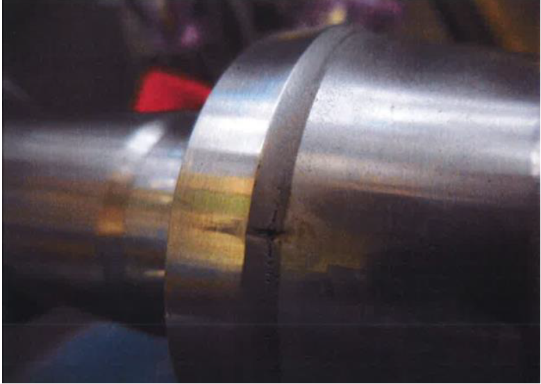

@Danlap: That looks very similar to our catalyst dust! Was that valve leaking as well?
I will contact above mentioned suppliers to get some quotes as well as their idea on the issue. Is there anything like "seat cleaning" (e.g. with pressurized air) before the valve closes to "blow away" any hard paricles.
@LittleInch: Is there a supplier you could recommend?
Below a Picture of the damage we found last year on the plug.

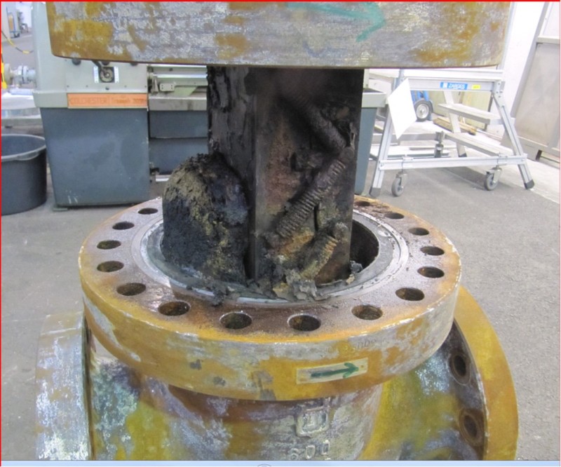

Hi DE01,
Yes, that double expanding gate valve was leaking. Now we are using through conduit slab gate valve, with better performance
Related to your "seat cleaning" question. For syngas application, there is always a debate not to introduce extra leakage path which in this case extra nozzle to blast the air. But I leave this up to you and process safety to judge
For that reason: we don't use it for sygnas application, even-though I love to try it. But we use that for catalyst cracking valve, and works well. Snip drawing as below (my excuse, I will delete this photo if there is disclaimer from manufacturer).
These supplier are FCC (fluid catalytic cracking) specialist: TapcoEnpro; Zimmerman Jansen; IMI remosa. Hopefully someone can make a smaller version for you
