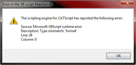

I've got a KW reaction that I really don't think is the best way to accomplish my task. I want to truncate a parameter, plus remove the units, so that I can convert it to a string, and build it into a part number. So, the reaction works... with limits. It is a bit clunky, and I have to believe that there is a better way.
What I want to do:
IF a number is less than 1 but greater than 0, drop the leading zero.
Always keep 3 place decimals.
Round to 3 places, and keep trailing zeroes, if they exist.
CODE
Sub main(parameter)
Dim inPart as Part
Set inPart = GetPart(parameter)
Dim retWidth As Double
retWidth = inPart.Parameters.GetItem("Width").Value / 25.4
retWidth = Round(retWidth, 4)
Dim strWidth As String
If InStr(retWidth, ".") > 0 Then
    If Len(Right(retWidth, Len(retWidth) - InStr(retWidth, "."))) > 1 Then
        strWidth = Left(retWidth, InStr(retWidth, ".") + 1) + 0.1
    Else
        strWidth = (retWidth)
    End If
Else
    strWidth = retWidth
End If
If InStr(strWidth, ".") = 0 Then
    strWidth = strWidth & ".0"
End If
inPart.Parameters.GetItem("WidthStr").Value = strWidth
End Sub
Function GetPart(inElement as Object) as Part
    Dim holder As Object
    Dim i as Integer
    Set holder = inElement.Parent
    i = 0
    Do While i = 0
        If TypeName(holder) = "Part" Then
            Set GetPart = holder
            Exit Function
        ElseIf TypeName(holder) = "Application" Then
            Set GetPart = Nothing
            Exit Function
        End If
        Set holder = holder.Parent
    Loop
End Function

Sorry, I pasted wrong code previously. I had already swapped strThickness for retThickness
However, your code is erroring out on this:
CODE
inPart.Parameters.GetItem("ThicknessStr").Value = format(retThickness ,".000")
RE: Knowledgeware Reaction - Drop Leading Zeroes, Round to .XX
ok my mistake this is VBA code.
Do you NEED CATScript or can you run VBScript?
Eric N.
