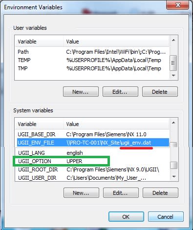

RE: Changing small letters to large with UGII_OPTION=UPPER NX 11 ?
then your changes are not used.
one way is to ask the server admin ( who ever set your system up and has access to that file)
In the meantime, try set the variable in the windows control panel, it will override the "\\PRO-TC-001\NX_Site\ugii_env.dat"
Start- type "system" , then select the option "edit the system environment variables" that appears in the dialog above.
select the "Environment variables" button under the "advanced" tab,
you can then either select NEW under user variables or system variables
variable: UGII_OPTION ( No "=")
Varable value: UPPER
then restart both NX and Teamcenter.
again search the NX logfile for the string "upper".
If this looks good, you can try the import.
Regards,
Tomas
Now NX 11 won't start when the code is in there. Should I try to restart windows or just remove the added UPPER code.
Edit the system environment variables
