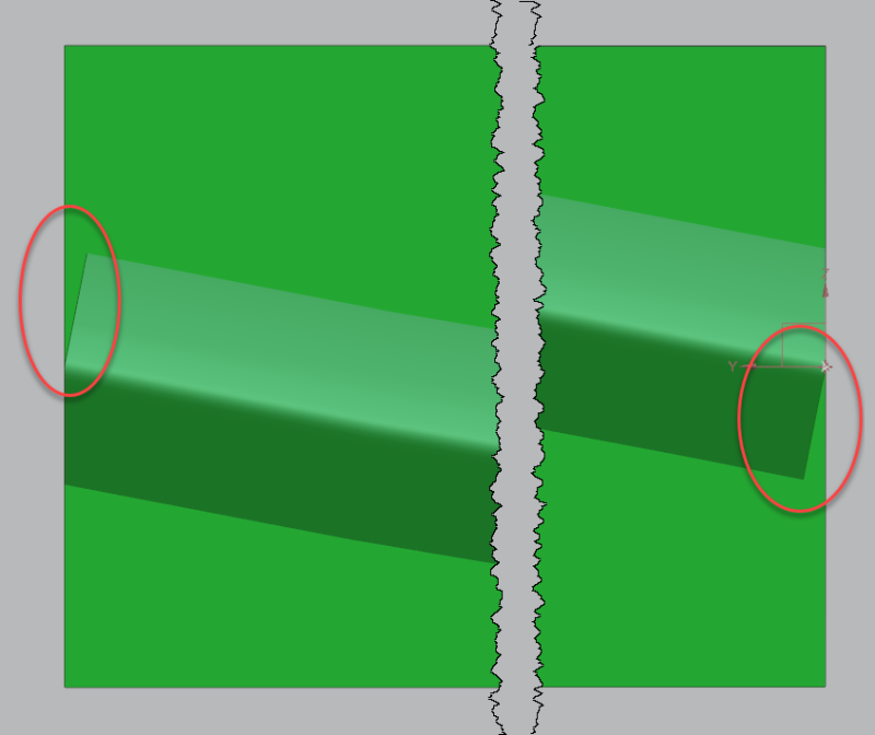

A few notes.
This model is very small, 1.72 mm the longest side. I hope this is as expected and not a translation error.
It consists of two main features, a freeform shape and a block.
The freeform should be subtracted from the block.
Since the bodies were imported, we know nothing about the accuracy of the respective body. . - the "block" consists of 6 sheets which have been sewn together.
The freeform shape is more complex than necessary for the shape, its single face is 3x3 degrees and 30x36 patches. ( what system is the origin of this ?)
In this case, the message in NX 12 is that the flat faces in the end of the freeform is intersecting with the flat faces of the block. This condition is very difficult for a solid modeler to calculate.( no matter what system we speak about, it is not a NX specific issue.) imagine two objects without thickness , in 3D space, which lie in almost the same plane, then one face ( still without thickness) should be subtracted from the next. Had the ends of the freeform extended outside the block with any distance, the operation would have been done in no time.
In this case, there is a neighbor face which is touching the face of block, but still fully enclosed.
See image below.
In this case, if you increase the tolerance of the intersect feature to 0.02, it will finish.
( NX will allow that enclosed face to cut the block open using the tolerance.)
Another method could be as like in the uploaded example. Using the Patch feature.
The patching tolerance will allow the " wobble" and the deviation that the freeform faces edges has to trim to the planar faces of the block.
see the section curves in the attached part, there is a tolerant gap.
This is still a watertight solid. Fully valid.

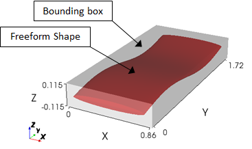

Dear All,
Thank you for the kind suggestions.
Tomas, the model is indeed small and is not a translation error. The model originated from a composite modeling software called as TexGen. The dimensions of the part file are as specified and required. The freeform shape is more like a yarn embedded in a matrix( here block) of a composite. After investigating the geometry, it seems that 2 parts viz: freeform and block are exported as sheet body. I think subtract boolean operation cannot be used on sheet bodies? Its like subtracting 0 form 0.
I tried to convert the bodies into solid by "Surface -> Sew operation" and then used the subtract boolean operation, the error of examine geometry pops ups. But now, the patch option also looks a sustainable option. I'll try this option on the actual geometry (much more complex model) which needs to be modeled and then let you know if this works or not.

Toost aka Tomas, you are just too good with NX. :) Kudos.
Just an additional question. Is there also a way to make a negative CAD in NX.
I have tried to make the freeform shape as a solid body by sewing the sheet body shape but I would also like to fill the bounding box and behave like a solid body. The only condition that it should account for another solid body here freeform shape while filling. What are your thoughts?
RE: NX12 Substract body
You can thicken the freeform shape.
If the rectangular cube is actually a solid body you will want to a Replace Face
You will replace the top face of the rectangular cube with the freeform shape.
If you do this it is always a good idea to make the freeform surface bigger than the face of the rectangular box.

You can also use the "trim body" command to trim a solid body (such as a block) with a sheet body (such as the "freeform shape" in your screenshot). To be successful, the sheet body needs to be larger than the solid. In the screenshot above, the trim body command would probably fail as it appears that the block is wider than the freeform shape.
