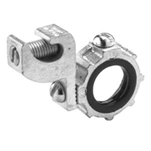

We typically use a gland connector that grounds the shield or armour to the glanding plate. The connector uses a bushing that has a terminal to connect a grounding pigtail. The grounding pigtails all connect to the ground bus. The PE terminals of the drives all connect to the ground bus.
The PE terminal should be and is connected to the ground bus.
Fault currents pass directly to the ground bus and do not rely on the drive mounting to complete the ground path.
Bill

Altough there is a connection through the gland plate, in addition, we use bushings with a wire terminal on the side. We use a copper wire to ground the gland connectors. We do not depend on the gland plate for grounding.
Our cables typically have an equipment grounding conductor inside the jacket.
The equipment grounding conductor is looped through the lug on the bushing and thence to the ground bus. This also grounds the screen or armour.
Bill
"Why not the best?"
Jimmy Carter

Thanks alot for your response Waross, I have learned something, especially those grounding bushings - I have not seen them used here in Australia.

Eddy currents that may be induced in the ferrous cabinet by the high frequency noise and resulting current, The equipment grounding copper wire has a lower impedance and the majority of the noise current is conducted to the ground bus by the copper equipment grounding conductor.
