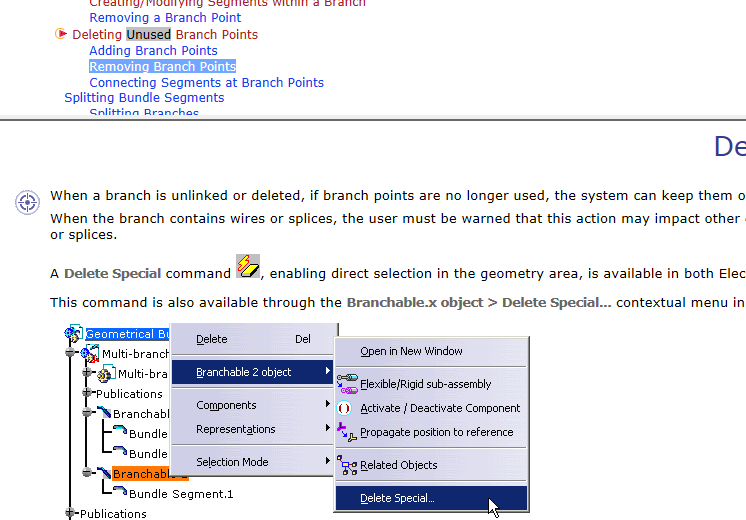

What is the difference between "Delete" and "Delete Special" in Electrical Harness Installation?

If not used with flattening module, both delete are the same. This is all I know :)

Yes. "Delete Special" is a little like the option box you get when deleting a Sketch and selecting to also delete parents, children or aggregated.
https://res.cloudinary.com/engineering-com/image/upload/v1518774786/tips/delete_yqttcp.bmp
If you've used points to construct a Branchable and you delete that Branchable the points will stay with "Delete" but be removed with "Delete Special" as they were children of that Branchable.
