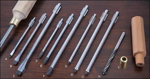

In addition to Greg's suggestion, I've noticed screwdrivers may have some 'wings' formed into the shank that gets a handle cast around it. That will provide some mechanical transmission of torque instead of just the adhesion of the cast material to the round shank.
This picture has a number of examples of what I mean:

RE: Screwdriver type manufacture
Or drill a small hole in the rod and then a small hole in the handle at 90 degrees to the rod and insert a pin or something to hold it in place and transmit torque.
If it's very small, say instrument screwdriver size, then knurling the shaft may be enough.
But if it's a normal size, and a prototype, I would suggest drilling and putting in one or two cross pieces to hold the handle.
