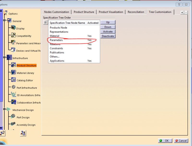

Did you activate the option at the Product AND the Part level? <= this might be for V5 only as I do not see any option in 3DX 16X for product.

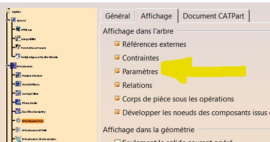

or here in Part Infrastruture

Hej,
It helped, thak's
