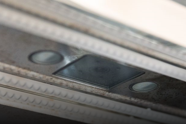

I'd like to share a similar product in the Market that is currently working.
This is the June Life Oven which has internal camera attached to the wall (internal oven temp reaches 500F)
What we want is to somehow use that approach.
Yes, there will be insulation in between the Lid and the Product (plan to use Fibre glass fabric or embedded with Aerogel) to protect the Product Housing form direct heat.
Regarding the Grill Lid temperature, since this is exposed to surrounding which is 40C, isn't it that the temperature above the Lid will not be that Hot as compared with the internal since it has been dissipated by ambient air (my rough simulation say's 200C)

Well if you look at the oven camera you will find that it is
a) very small
b) behind a glass screen
c) almost certainly isn't attached to the metal hot part of the oven
d) only has a very small amount of heat entering its domain.
your current design has none of those things, what ever it is.
The electronics of the camera will be mounted on the outer shell well away from the internal hot oven casing and even then will probably get pretty hot unless they blow cooling air around the inner oven which will be completely covered in insulation, unlike your BBQ
you need to sketch your anticipated design out a bit to see what it looks like, but for me and as noted above, you will need a awful lot of air moving over a big heat sink.
