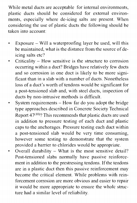

Do you guys know why EC2 clause 7.3.1 requires PT structures under XC3 to be under decompression under quasi-permanent load? My interpretation is to prevent corrosion of strands. And my question is if we are using plastic HDPE duct, do I still need to check for decompression? If no, is there any specific tests or requirements (e.g durability test, chemical composition etc..) for HDPE duct to be eligible to use without complying EC2 decompression requirement. I did send my queries to CEN and EOTA yesterday so far no reply yet so ... Hope you guys can help me out like you always did :).
Even in TR43 mentioned that plastic duct should be used for external environment but does not mention the type of duct. Does it mean any plastic duct will do?

Most plastic duct I have heard of has been used for multi-strand tendons.
VSL USA (when they existed in the 1990's) tried a plastic 2 strand bonded system but as I understand it, that suffered a very quick death as it was too expensive.
