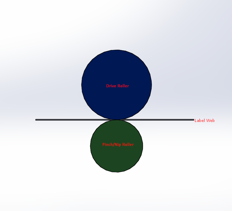

See basic drawing below. Basically the web path is pinched between the drive and pinch roller which causes it to be fed. I need to design a way to engage both roller aswell as disengage them easily.

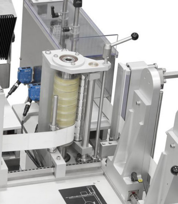

I found this online. Does anyone have any idea how this could work? The pinch/nip roller is engaged by turning that handle with the black ball tip.

By simplify this I meant I wanted to simplify it for the customer to changeover labels. I did not describe the current system well. The nip roller is in a guideway and is adjusted in and out with a handle. There is a spring both on top and bottom so that the pressure remains constant. The problem with this is the handle needs to be turned quite a bit to spread the rollers apart. It is not difficult to use but some of our customers have seen other brand labelers with a quick release and engage knob. I have not seen it myself, but basically a knob is turned 90º and the rollers engage with each other. I assumed this was done with a cam but I might be wrong.

Look at the other brand machines to find out why your customers like the mechanism, then improve on that.
