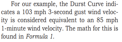

I might be misunderstanding, but it sounds like you're looking for the Durst curve -- a statistical correlation between wind speeds over different time frames.
It can be found in the commentary of ASCE 7, among other places.

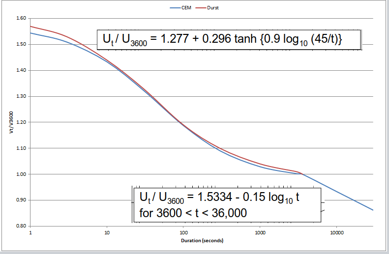

From memory, the Coastal Engineering Manual has a conversion equation (probably in the section on wave forecasting/hindcasting).
Edit: Remembered I have a spreadsheet with this conversion formula in it. 3sec:39m/s is 10min:27m/s using the CEM relationship.

Thanks Lomarandil & Steve,
I can roughly back up Steve's numbers with V3 = (1.52 / 1.06) * 21.5 = 30.8 m/s.
Therefore London basic pressures are roughly 38% less that of Melbourne.
Example calculation using the Durst Curve below, if anyone is interested.

It's probably not strictly relevant to a comparison between Melbourne and London wind loads, but AS1170.2 appears to say its wind speeds are 0.2 second gusts (see notes to Table 3.1), not 3 seconds as it used to. The references to 3 seconds were removed in 2012 and replaced with 'peak' gusts. If that's the case, then 0.2s:39m/s corresponds to 10min:26.2m/s according to the Coastal Engineerig Manual formula.
I've also attached the CEM formula: more convenient than reading from a graph in a lot of cases; and goes beyond 1 hour durations with a supplementary formula. Fairly good agreement with Durst's curve.

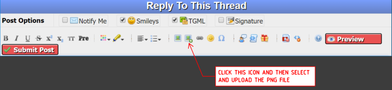

Link to image below. I can't figure out how to display it within this post from engineering.com. Any hints appreciated.
Link
RE: Wind Speed Comparisons
Quote (steveh49)
From Eng-Tips.com (NOT engineering.com):
Resulting in:

Revised numbers --- LDN pressure = 0.67*MLB or 33% less.
