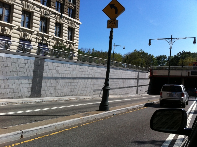

[img ]
These are stone panels anchored to a concrete wall. The stones are set in concrete panels. Maybe not what you're looking for. The panels did have special anchors though; not the typical catalog stuff. I can post the contract drawings and I don't need to black out the engineering company's name - it was a publicly bid project. I don't have copies of the shop drawings.
