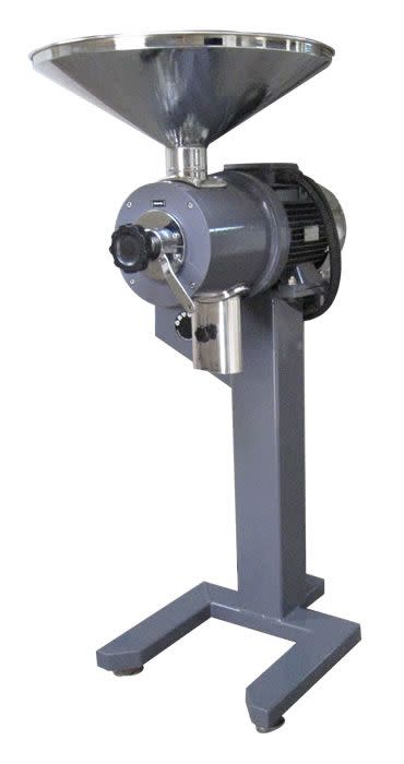

Would that I could. I'm a wholesale coffee roaster. Right now I run 3, 1hp grinders and I run them just about all day, every day, shutting them down for long periods to cool. It's just past 10pm here and my son is still outside grinding coffee. This is a huge bottle-neck for us.
To replace the grinders would run me about £2k each for an equivalent grinder.
Just this past Friday I ground all day but didn't keep up with my orders. This meant grinding 1/2 day Saturday and 1/2 day Sunday. All this grinding takes it's toll on the grinding discs. So when the grind quality deteriorates I have to remove the discs (the grinders are no longer made by the way) and send them off to a great guy in the UK to be sharpened. And sometimes he has to make me new discs when they are beyond sharpening. In fact I'm waiting on a new set right now. This downtime of one grinder puts more strain on the other two grinders and round and round we go. So I know I'm spending a lot to make this work but as my son likes to say, 'It has to be done'.
The grinder I'm buying will keep up and beyond which I need because of some new markets opening up for me. The grinder is costing me X. An alternative grinder, that I could just plug in and go on my house current would cost me XXX. So spending X or half-X to convert the power seems to make economic sense.

That looks like a standard motor frame, it would be conceivable to swap the motor for a 230V 3 phase unit and then get the 230V 1 phase in 3 phases out unit, although its getting up there in terms of size of a single phase (input!) VSD. This may well be cheaper than getting a transformer.
Admittedly, it might also be possible to replace it with a single phase unit, although its generally a less than optimum solution. That option will get around the issue of having to rewire the unit to split the VSD output from any control equipment that is fitted, although in order to start and stop it you'd probably need to do that anyway.
The other consideration is that there's no way around the 5.5kW size of the grinder. Whatever VSD you use will need a suitable supply for it, and if Ireland is anything like Australia, single phase socket outlets only allow a certain size (about 2.4kW here) to be powered from them. Thus, no matter what you do, there's modifications to the house wiring to be done, you'd likely need a 25A socket outlet (or get the electrician to hardwire in the VSD).

The motor swap is a fair suggestion. I can't tell from the photo if it's foot mounted or flange, or a hybrid, but there are plenty 230VΔ/400V Y motors available from reputable brands at ~£300 or so. 132S is a standard IEC frame size, so it should be any easy swap, and would open up the option to use a 230 in / 230 out phase converter or a VFD without the additional cost and complication of a transformer.
RE: Do I need a ROTARY PHASE CONVERTER or a DIGITAL PHASE CONVERTER or an INVERTER?
This is the grinder. It will cut my grinding time by 75% (and this is taking the manufacturer's throughput claims and halving them).
It looks to be really easy to change motors on. I'd sure consider switching to a motor that's 230V/50Hz.
It appears to have no other controls other than ON/OFF so a VFD is certainly a clean option.

To make it simple, compare the cost and availability of a motor with the cost and availability of a transformer.
But first check the shaft. Make sure that this machine doesn't have a special shaft.

You won't get a single phase motor of that power output in that frame size because they don't exist. To be honest you'll struggle to find a 5.5kW single-phase motor at all, because there's next-to-no demand for them - most places needing motors that big have a three-phase service available.
You're looking for a motor with these characteristics, if you fancy going shopping:
4-pole
5.5kW
230VΔ/400V Y
132S frame
B35 foot-flange mounting
Most of the decent European manufacturers - Brook, ABB, Siemens - have optional feet to convert a flange-mount motor (B5) to a foot-flange (B35). Your local overhaul shop should be able to get them at a nominal cost if you find a flange-mount motor which meets your requirements. Otherwise a decent brand motor is about £350, innominate stuff from China or worse will be about £200.
On top of that you'll need a VFD of around 11kW - 15kW or so, capable of 230V in / 230V out. If you're lucky then you might find a North American VFD with an input designed for 208V 3-phase which will generally accept 230V single phase; I found an A-B 1336 drive on ebay a few years ago which is currently powering the lathe in my garage.
If you have a local motor shop you may inquire about the cost of re-connecting or re-wiring the motor for 230 volts.
They may be able to access the jumpers between coil groups and do a re-connection without a re-wind.
Have you inquired of the manufacturer as to the availability of a 230 Volt machine?
You may be able to exchange the motor at a reasonable cost.

To me, the photo suggests that the motor has both a C-face or similar flange, and a foot.
I'd advise demounting the grinder part and carefully measuring the motor shaft and flange if any, before ordering another motor.
If you are really lucky, maybe you can find a complete spec for the motor, or at least an exploded view of how it all goes together.
Mike Halloran
Pembroke Pines, FL, USA
Mike,
In IEC-land that C-face with foot is a B35 mounting: B3 indicates a horizontal motor with foot, B5 indicates a horizontal motor with flange.
132 frame is the shaft height in millimetres for a foot-mounted motor. The 'S' suffix indicates a 'short' frame, with others being 'medium' and 'long'. 132S is the standard frame for a 2-pole or 4-pole 5.5kW motor. The standard shaft diameter for a 132S frame is 38mm.

If it were me, I would start by taking that motor to your motor shop and have them crack it open to see if they can find the winding ends to reconfigure it for 230V. I’d be willing to bet they can. Then you can get a suitable 230V VFD and be done with it. You might find that having the variable speed will give you some added control of the grind as well. If they can’t reconnect it for you, they can probably offer you one with the right mounting and shaft as that one, but has the 230/400V connection capability.
jraef,
Unlikely that there will be any winding ends other than those in the terminal box. It won't be built like a US 12-lead motor, I'm pretty sure that winding will be straight 415V.
We are talking about the internal jumpers between individual coils. A motor shop may be able to add leads to make it a 6 or 9 lead motor. (12 leads are generators, motors are 9 leads.)

Gentlemen, based on what I'm hearing are you saying (jraef's post) this motor won't work with a VFD or if I have a motor that is not VFD friendly I need to put a dv/dt filter (don't know what that is) in the line feeding the motor?
Also from what I've gathered y'all are suggesting these configuration option from 1st choice and least expensive on to last choice and more expensive?
Oh, and by the way, since I'm talking about expense the digital phase converter which looks like I put house power in one end and 415v/3ph comes out the other end is about £1,800. The rotary phase converter is £1,360. It sounds like your solutions are a lot less £. The main thing it looks like I have to watch out for, since I've only got 60A to put on a circuit, is what the motor wants in amps to start. If that surge is too much I'll be tripping breakers (the digital phase converter, I'm told by the manufacturer, has a 'soft start' so that tripping breakers isn't a problem. And both the rotary and digital phase converter manufacturers now say I can put their gizmos on a 40A circuit). And then once the motor is running it settles down to 10A and we're all happy (and the neighbors too - although not many of them, one across the street and the next one 1/4 mile away).
I digress. So the set up options you think are best, and I'm ranking them in order of expense as they all seem like they will work. Also it seems that as I flesh things out this way the least expense is also the simplest solution. Is that a fair statement? For all these solutions I would put in a dedicated circuit running off its own breaker.
1. If possible convert the motor itself to 230v/3ph: mains ===>> VFD converting 1ph to 3ph power ===>> filter (maybe) ===>> converted motor ===>> coffee is grinding
or
2. Motors are fairly inexpensive so if I can get a 230v/3ph matching motor, buy it and wire it in: Mains ===>> VFD to go from 230v/1ph to 230v/3ph ===>> motor ===>> coffee grinds
or
3. If I have to use the motor the unit comes with: Mains ===>> phase transformer (230v/1ph to 230v/3ph) ===>> VFD ===>> motor ===>> coffee grinds
Would those be the three choices that y'all lean to the most?
Almost.
"phase transformer (230v/1ph to 230v/3ph)"
Should be:
"phase transformer (230v/1ph to 230v/1ph)"
Wait, Bill missed it a bit too.
Quote:
Should be:
Should be:
230v/1ph to 400V/1ph or 460V/1ph
And I'd skip any filters unless obvious issues appear. Save your money.
So:
4. If I have to use the motor the unit comes with: Mains ===>> phase transformer (230V/1ph to 400/460V/1ph) ===>> VFD to go from 400/460V/1ph to 400V/3ph ===>> motor ===>> coffee grinds
Best bet with the given motor for lowest, nearly non-existant starting shock to your power supply.
Keith Cress
Excellent! Thank you! I just got off the phone with Donegal Rewinds and ran some of your suggestions by them. They said it all makes sense, they just need to see the whole unit and then can figure out the best way to go -- new motor, modify existing, inline kit (VFD, filter, etc.). So I'll also pass along the motor information you've supplied.
