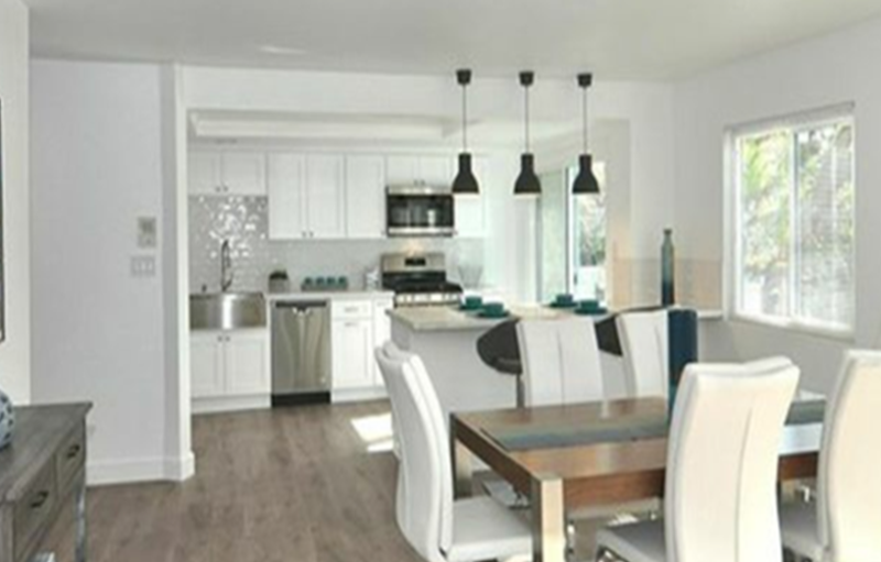

Hi Folks,
I'm an aerospace engineer, and I was hoping to get some input from my structural brethren. I am on the HOA board of my condominium building. It's a 2 story wood frame building. An owner on the 2nd floor removed an internal wall without approval from the board back in November. We pushed back on them, and it looks like they just had it inspected by a structural engineer (current licensed PE). The engineer's report was light on detail, and it obviously came after the wall was removed. I just want to run it by knowledgeable folks and see if it passes a smell test.
The report states: "A job site visit was conducted at ------ in regards to a wall that has been removed. Based on visual inspection, the wall is neither a vertical load bearing wall nor a lateral resisting shear wall. It was observed that the wall is running parallel to the direction of the framing, which precludes the wall from being a bearing wall. The top of the wall is not tied to the roof diaphragm, which precludes it from being a shear wall. It is the office's opinion based on the field observation, the wall that was removed does not affect the structural integrity of the building."
If you want any additional details, just let me know. I really appreciate your input.

I would tend to agree that the evidence suggests NOT a load/bearing/shear wall.
However, if the structure was built under the provisions of IBC 2308 - Light frame construction - that section relies on multiple walls "acting" as shear walls with little direct detailing requirements related to hold downs, diaphragm connections etc. It could be that you have a light frame construction building and you've removed a braced wall line that now doesn't meet 2308 provisions.
I doubt it is the case but thought I'd post that idea anyway.

-I don't know anything about building codes or light frame construction, but I can ask the PE. It's a smaller condo building (basement garage + two floors of 7 units each). Seems like that could fall into Light Frame Construction. Any way to know for sure? Also, is there anyway to tell if the wall would have been 'acting' as a shear wall, other than the original plans, which I cannot get?
I actually have a before/after photo, so that might be useful
Before:
After:
Thanks again for all the help.

40 years old = 1978. The 1976 UBC did not have provisions for "Light Framed Construction".
RE: Quick Sanity Check Requested - Removing an internal wall in a wood frame building
All of the length of the wall past the start of the opening would probably be ineffective to behave as a shear wall. The left end could also be ineffective depending on the height-to-width ratio.
