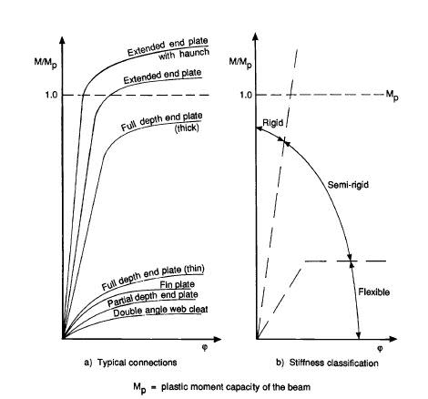

I have been doing some thinking on idealized vs. real connections and I'm looking for a good reference, or explanation that helps me understand when it is really safe to assume pin connection and full moment connection.
My train of thought started today thinking of two trusses spaced 15' apart with purlins running between them and the purlins nailed to the top of the truss. Now I picture a load in the center of the purlins and think surely that would create a moment on the trusses and a great enough load would pull the tops of the trusses in and collapse them. To me it seems like the nail through the top of the purlins create some moment resistance and makes the trusses unstable with only a nail into a top plate supporting them. Is this correct and the only way the trusses stay upright is due to sheathing, Or is the connection with the purlin truly a pinned connection and flexes enough to not allow lateral deflection of the truss?
Again any reference material on the idealization of connections and how we can make these assumptions would be appreciated, so I can feel safe that one day I will not have trusses that topple :)

The connection you describe is most definitely a pinned connection.
I don't have any documentation that would give you guidance.
Unless you are providing significant connection of both purlin flanges to the supporting material then the connection can usually be idealized as pinned.

That last comment by LeonhardEuler hits the nail on the head if you'll pardon the expression. If the purlins are designed in accordance with code, they should not deflect more than L/360 under live load. A simple span purlin would rotate approximately 1/100 radians at the truss under full snow load which could easily be accommodated by localized squashing of the chord member and purlin, not to mention strain and pullout of the screw or nail.
To state that the connection is not a perfect pin is absolutely correct. Some moment will be transferred, but not nearly enough to cause the trusses to collapse.

The load will always follow the stiffest path. In your example, the lateral stiffness of the truss is probably less then the compressive stiffness of the purlin and shear stiffness roof diaphragm. Therefore, if / when the purlin applies an end moment to the truss, the truss deflects first (e.g. the end moment is relaxed) and instead resisted by compression of the purlin and shear across the roof diaphragm.
RE: Idealizing connections
I'd start with the stability bracing requirements of AISC 360 and commentary for digging into the "why". It's Appendix 4 in AISC 360-10 (red book). You can calculate out what the required brace strength and stiffness is in order to keep a beam under a given moment from rotating or LTB.
You'll find it often doesn't take much.
