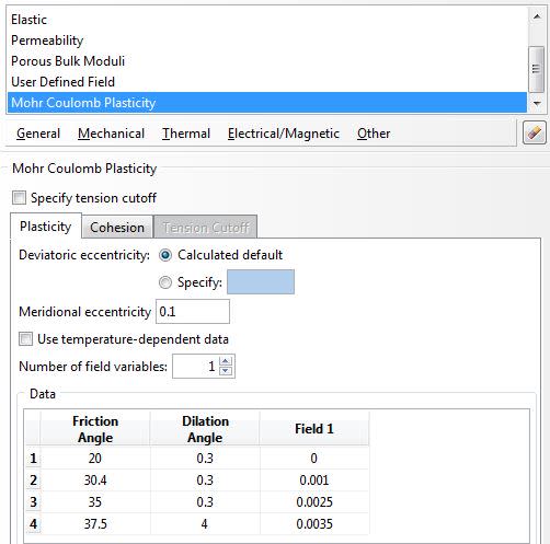

i have a Stress-strain curve from experimental results. i want to model this experiment with abaqus but i don't know how exert load in models to reach this curve, Do i use experiment stress-strain curve for exert loads in boundaries?
picture of axial stress and radial stress and axial strain is available in below:

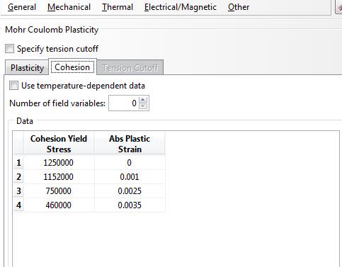

i have other material property like elastic modulus, void ratio, Poisson ratio, density, cohesion yield stress and abs plastic strain.
my problem is that i dont know how exert load in load module,
i have to use SOIL step and pore fluid responses are transient consolidation. There are no talking about how long time period is.
so what can i do?
