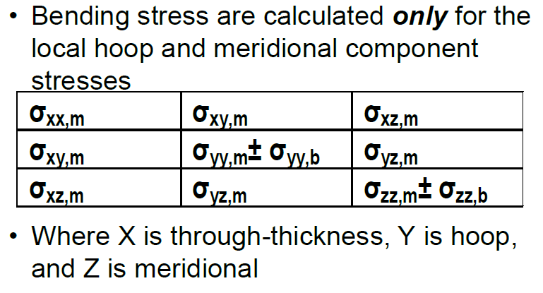

Hello Prex/TGS4,
I red your previous posts you wrote regarding ASME SECTION VIII, DIVISION 2 ANNEX 5.A.
I am still not 100% sure how to calculate it
The first two steps of ANNEX 5.A are clear. I am confused how to calculate Bending Stress and Membrane + Bending Stress:

Bending Stress:
In a post here in the forum user Soave posted on Mar 17 calculated the Bending Stress with the formula:
Sb = VonMisesStress (Sbxx, Sbyy, Sbzz, Sbxy, Sbxz, Sbyz)
At pveng.com
PbV = VonMisesStress(Snb, 0, Shb, 0, Tnhb, 0)
First question: According ANNEX 5.A bending stresses should be calculated only for the local hoop and meridional (normal) component Stresses, therefore I think pveng.com used the right formula?

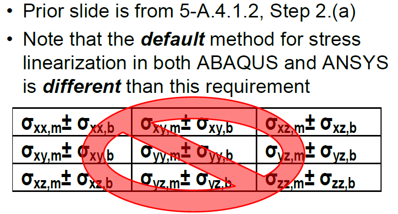

RE: Stress Linearization 2nd thread
This is the right way.
This is the wrong way.
These are from my training class (hence the reference to "slides").

TGS4, What is the motive for not including the bending effects of the through thickness stresses?
I know this is the procedure as provided by the code but I do not know what the reason is. My guess is the following:
For the through thickness shear stresses since they have a distribution like a parabola the moment around the mid-point is very close to zero.
For the through thickness normal stress I do not have any idea why bending effects are neglected.
How much does that neglecting change the results by the way?

TGS4, there is also 5.A.4.1.2.b.2, and as 'needs to be considered only' to me implies 'but may be considered in all cases', I would say that, to promote standardization of procedures (and also because I don't know how to check whether a stress distribution results in torsion...), it would be simpler to include in your first table the σyz,b component. This is what pveng.com does, as reported by Robse (I didn't personally check) and I think it is a correct procedure in all cases.
Robse, concerning the peak stress, only the tensor is defined (at wall surfaces) in STEP 3. If you refer to Step 6 in pveng site, then that's not the same; they define the peak stress as the highest stress resultant on the SCL, whilst STEP 3 in App.5.A defines the single components of the peak stress as the increment of the total stress components at wall surface with respect to the previously calculated m+b stress components (where some b components are zero).
Concerning your second question, I don't see your point: STEP 3 refers exclusively to the peak stress tensor (and not to a 'Membrane + Bending Peak Stress', as you say; such a quantity is not defined in the code).
Your last question is already answered above. But you don't need to visualize the m+b stress along the SCL, as the code only requires to determine the stress resultants (VonMises here) at wall surfaces, the rest doesn't matter.

Quote (prex)
There is no implication. The rules are as-written. If you disagree, you are free to request an interpretation from the Code Committee.
paulettea- the explanation in WRC429 (and mostly repeated in PTB-1) is thorough.
The implication, for me, comes from the fact that 'needs be considered only if' isn't the same as 'must be considered if', but rather 'can be considered always, but is required to only if'. Words count. That wording should be clarified.
