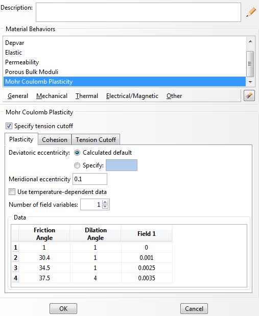

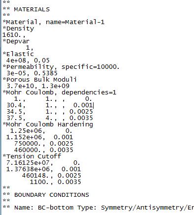

Hi everyone
i wrote a USDFLD subroutine in abaqus and i want to see is it correct or not?
my friction angle and dilation angle varying with plastic strain(PEEQ)

pictures of material property and a part of .inp file is available in below link:
thanks for helping
