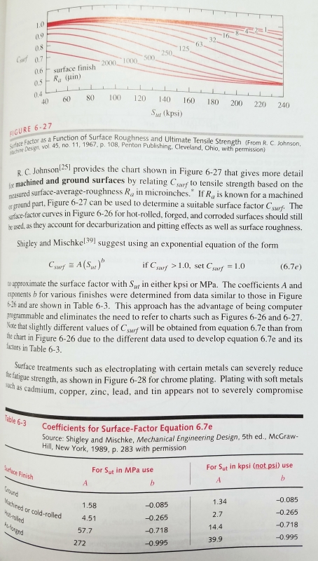

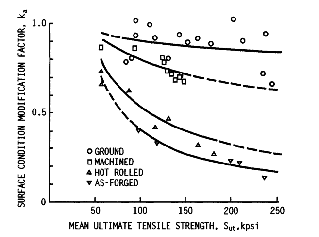

My old machine design book has a graph of endurance limit vs. tensile strength as a function of the surface finish but the finishes are listed as forged, hot rolled, machined, ground, polished. You could then look up the typical surface finishes for each of those processes and combine the results.
The graph shows a significant difference between ground and polished as well as machined and ground but the differences get smaller as the tensile strength gets lower.

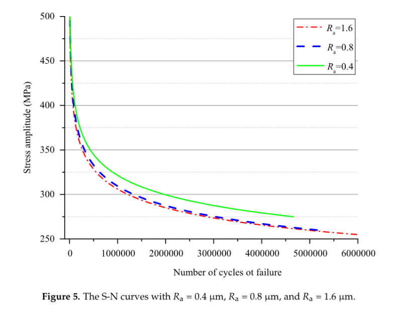

This discussion did eventually lead me to an interesting finding though; one that supports some of the earlier suggestions of a 10 or so µin finish. It's not the one I'm thinking of, because it's from 2017 (so there's another one out there as well!), but I think it supports this line of thinking.

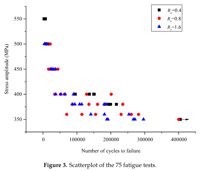

Fatigue Life Estimation of Medium-Carbon Steel with Different Surface Roughness. They took 75 samples of three different finishes (note they're using Ra in micrometer. 0.4, 0.8 and 1.6 would correspond to roughly 16, 32, and 64 microinch, respectively), and ended up with a plot like this:
Looking at the above plot, say we had a Stress Amplitude of 300 MPa (~43 ksi). The 64 and 32 finished specimens tended to fail at around 1.25 million cycles. The 16 finish, on the other hand, tended to last until about 2 million cycles.
Granted, the above plot is a reduction of the actual data, which is a bit more messy:
Additionally, there were a fair number of samples, but only 3 different finishes. So there's not a lot of granularity in where that cutoff is. All in all, it might be a specious assumption, but I suppose it can't hurt to say you need good finishes on things you need good fatigue life on. And this gives a rough place to start from. At the very least to start with testing to verify the fatigue life of the design. Also, probably with all fatigue questions the probabilistic nature of it means that it's difficult to make such a hard and fast rule.
For anyone that is still thinking about this, on further introspection, I think it was actually a semi-log plot, so that when the number of cycles were converted to a standard axis, the difference was even more stark. If you find it, feel free to share.

In addition to all the comments above, I think although there is definitely a correlation between surface finish and the fatigue life, the original question seems to be of the mindset that improvements in the surface finish say from 125 μ in. Ra to 63 μ in. Ra will give an improvement in cycles to failure, but will have asymptotic effect. Not arguing with the correlation, I just think that might not be the best way to think of it.
Remember that in the end, our knowledge of fatigue is overwhelmingly based on test data and correlation to it. There are a lot of complexities and great engineering in LEFM, EPFM, exact solutions for geometric effects on crack propagation, etc. But ultimately, even our crack growth models are correlation to test data. For example, even the NASGRO equation, with the fancy crack closure function and all the other improvements over previous equations (Walker etc.) is still just trying to curve fit to known behavior from tests.
For most rotating beam tests or whatever is done, the specimen is polished to a mirror finish. So that is one baseline of our knowledge. For that finish, we can predict a fatigue strength or endurance limit. Then, we apply special factors, one of which is for differences in surface finish, to knock this down.
So rather than thinking we have some baseline, and improving the surface condition will make things better and better at a decreasing rate, it may be beneficial to think that we have some known ideal baseline for which the surface factor is 1.0, and discrepancies in the condition will make the fatigue strength worse and worse.
You can get an idea of how the type of knockdown on the fatigue strength you get from different surface finishes as shown below:

LPS LiftDivergence. What publication is the above taken from?
RE: Cutoff of relationship between surface finish and fatigue strength?
The publication I referenced is:
Norton, Robert L. Machine Design: an Integrated Approach. Prentice Hall, 2011.
Specifically the fourth edition. One of my favorites, the way Norton writes is great.
