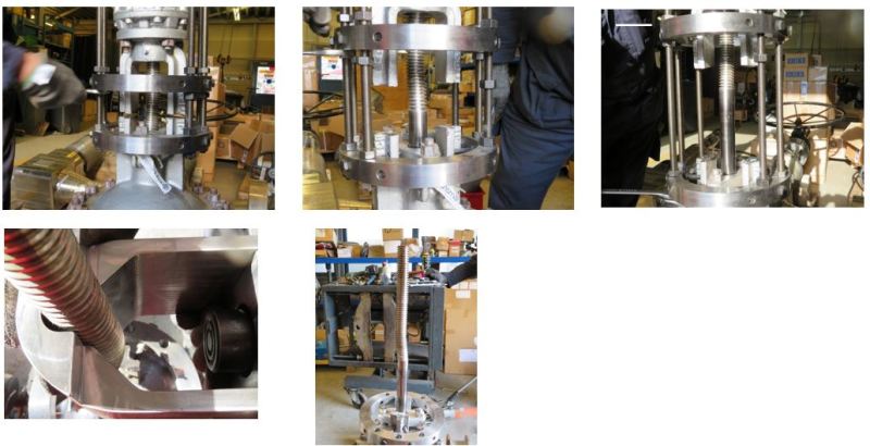

Just some update over the mockup test. Fortunately, it works, and (unfortunately) it justifies that we can and will do the exact same thing with real situation under toxic service and 180 bar in the field.
Mockup parameter: same spindle diameter and material as the real valve (in this case 35 mm), similar gate valve, during all activities valve was under pressure with water @25 barg
Goal: to open the valve in full backseat position
Assumption: mock-up bent stem is representing the actual condition
Activities in order: (valve in close position); brace the yoke with two “rings” which had been calculated prior; cut the yoke; pull the spindle by means of slowly retracting the long studs connecting the top and bottom “rings”; always monitor the leakage; once back seat position – remove gearbox – straighten the spindle with pre-prepared hydraulic tools
It is highly risk job, and I do not suggest or encourage people to try this under pressurized system. Just some idea when it is really really really a must do and (almost) all risk have been addressed
What needed:
-(Ideally) mock up test
-A clear understanding of current situation (how is the bending condition, how is the gland condition, valve position, etc.)
-For sure several experience maintenance personnel who can do this job with Swiss watch precision workmanship. and can synchronize movement/communication between one and another
-Gland packing leakage monitor / control
-Pre-calculated bracing tools
-Stinger / gland sealant injection mechanism shall this attempt about to fails
-(if required) tools to straighten the spindle. By the way, It would not be a perfect result
-DO NOT STAND or put your body parts in the line of fire
-Mitigation. As maximum as possible, including clear path to RUN
-Debate, debate and debate. And challenge session(s). and approval from safety and management
With photos as follow (mind the brand unintentionally captured within the photos – they are all good supplier 😊). I feel the need to share this, but I leave the interpretation of this lesson learned to all of you. BE CAREFUL
Will do the actual action in a few days, cannot take photos. Hopefully everything will be safe

I get the bit about how you take the gearbox off, don't agree with the shaft straightening, but think you've already got that, but then what?
You've cut the yoke in half to get the gearbox off and get access to the spindle but how is it going back on?
Can you not undo those 4 bolts you can see on the top picture?
Clearly you've been looking at this for days with all the relevant drawings and parts, but cutting the yoke sounds to me like a one time operation with no way back?
Also did you miss out the line - someone watching on CCTV with their finger poised over the ESD button? I can only hope there are some nearby fast acting ESD valves in case this really starts to go wrong.
RE: One of those days
long story short: valve should be open to "wash" the vessel and mitigate the salt induced corrosion. Not part of my specialty (excuse the wording), but more or less that's the idea.
That is indeed point of no return, we cannot undo the 4 bolts (it will be 8 in the real situation) once the yoke is cut. Once back seated, I personally would vote for secure the area or at least that valve area until next replacement, and only use the other valve (by the way this is double block configuration times two set).
Rest is more political (plus some theoretical process concern) rather than technical. They are afraid some water will pass three valves (two DB in series meaning four valve minus this one) and do some damage to the vessel.
So that is why the idea to is mount a hydraulic hand operated actuator mounted in the remaining yoke to make this valve operable. Om which I am against, due to the risk someone may "crush" the packing during the spindle adjustment with this new actuator
Plus removing the yoke is due to the rack and pinion within the gearbox is already compromised.
"someone watching on CCTV with their finger poised over the ESD button?" Unfortunately this is the first valve next to the 180 bar vessel. So literally if something goes wrong, the (full moon suited) workers will have to run and in parallel depressurized the vessel (can take up to 5 hours to reach atmospheric pressure). I am sure there is a ESD button somewhere, but how the process goes I am not sure.
Any smallest and unstoppable gland leakage will initiate this event.
