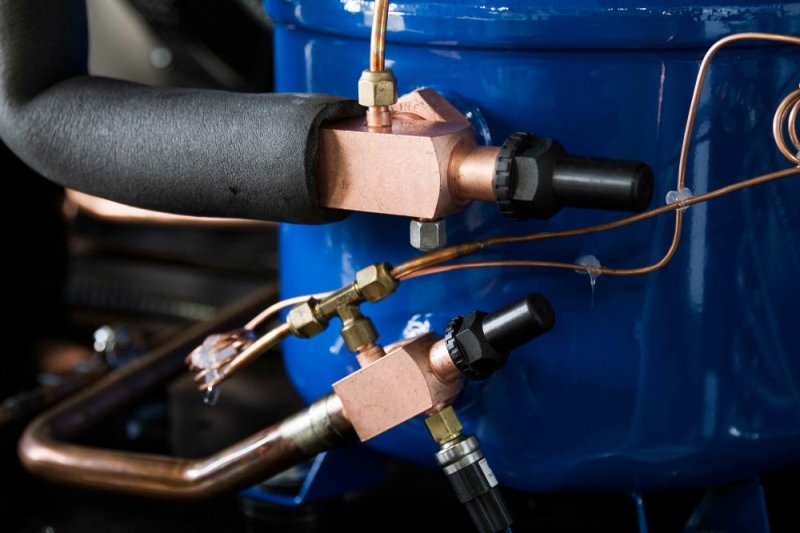

Yep. Often called "service valves". They're gas tight capped valves that allow you to isolate the pressure switches for replacement without having to reclaim the entire system charge. There is often ports with said service valves in the compressor or even threaded ports on the compressor you can install the service valves in.
Typical example:
