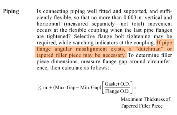

IMHO, with a gap the joint cannot be slip critical. I would not search for some code "loophole" to allow acceptance.
Perhaps if a proper tapered filler piece is used, the problem can be corrected:
