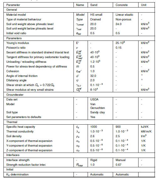

4. I've found that populating a parameters table before you start is a helpful reference (in a single view), and makes model input more systematic. Like this (taken from a Plaxis tutorial example):
Good luck
