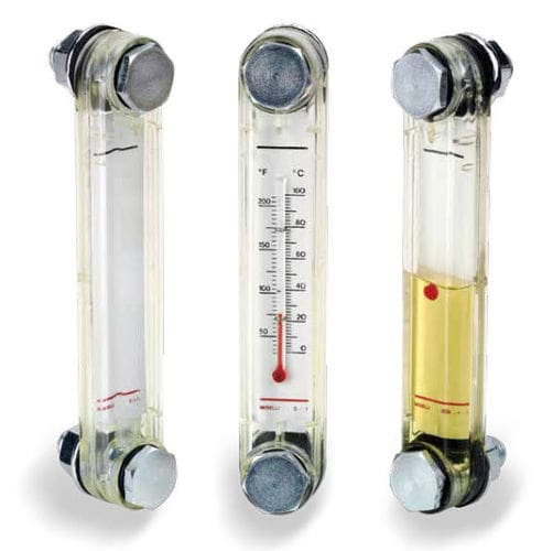

Dear Instrumentation experts, Could you please suggest, What is the purpose of Red and White stripes on Level glass gauge? ( simple hollow transparent tube ). This level tube is installed at open to atmosphere water tank.

If the stripes are vertical, they help to make different coloured fluid levels visible under different lighting conditions, particularly clear fluids.

From a catalog:
"This type of gauge glass has red and white meniscus enhancing lines. This is achieved by the application of specially developed paints that are bonded to the glass without etching."
